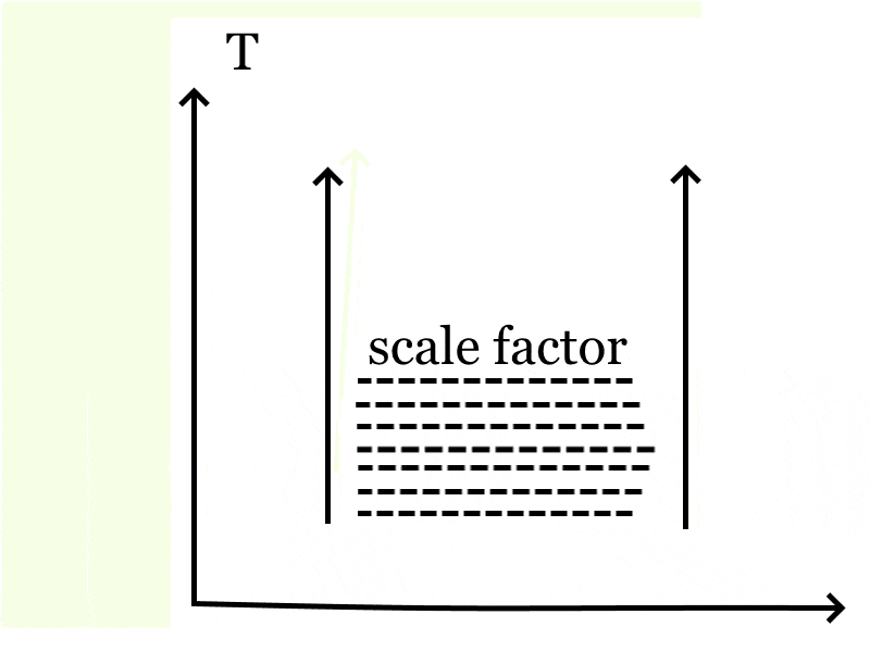

It's hard to say what explanation will be "cognent" for you. I'll pick one that's easy to draw.
You can not draw a space-time diagram that's to scale on a flat sheet of paper. So we need to introduce the concept of a scale factor. We'll do that with a dashed line, labelled "scale factor"
The dashed line is of constant (proper) length.
So, on the space time diagram, the vertical lines represent the position of the test masses, which in the diagram have constant x coordinates, so they are just vertical lines. However, while the coordinates are constant, the coordinates do not represent distance in a uniform manner because of the time-varying scale factor. So the coordinates have no direct physical significance, they are convenient labels to describe the geometry.
The dashed lines on the diagram represent a constant proper distance. So they represent the scale factor, as one might see on a map. As you can see from the diagram, this scale factor changes with time. So while the free-floating test masses have constant x-coordinates, these coordinates on the diagram are not and cannot be "to scale". The distances on the diagram are represented by the dashed lines representing the scale factor, you can think of them as representing rulers of fixed proper length. So to recap, the diagram isn't to scale because it can't be, to understand the diagram one needs to understand the graphical representation of the time-varying scale factor.

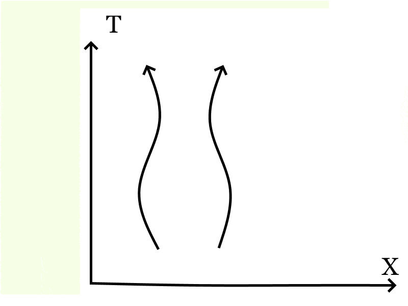

I wanted to add a few things to my post. The previous post is OK as far as it goes, but it only shows one spatial dimension, not three. The actual GW has three spatial dimensions, two transverse spatial dimensions, plus the direction of propagation, and of course time. On refelction, I think that the "can't draw on a flat piece of paper" argument really applies only to the full GW. I don't currently see any reason why one couldn't draw the worldlines of the two test masses as below for the 1+1 slice.
The second choice as drawn above seems a bit more intuitive to me, though the first choice represents the usual usual math better. The two different diagrams represent two different descriptive approaches that yield the same experimental results. The first might be called "expanding space", the second could be interpreted as the test masses actually moving due to "gravitational forces".
This is the diagram I had in mind in my last post - if you stack up the frames of the animation from Wikipedia and then cut the stack vertically and look at the cut edge, you get your last diagram.
As long as they do not cross and the metric is not specified, you can draw your world-lines however you want ...
