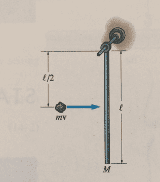

A rod of length l and mass M is suspended from a pivot, as shown The rod is struck midway alongs its length by a wad of putty of mass m moving horizontally at speed v. The putty sticks to the rod. Find an expression for the minimum speed v, that will result in the rod’s making a complete circle rather than swinging like a pendulum.
Attempt at a solution:Use Conservation of EnergyKinetic Energy of Putty = Energy of Putty and Rod at the top of swingmultiply everything by 2##mv_i^2=[(\frac{l}{2})^2m+\frac{1}{3}Ml^2]w_t^2+2(m+M)gl\\\\##where w_t is the angular velocity at the top and v_i is the velocity of the putty originallyat the top of the swing the minimum velocity is related to the centripetal acceleration being equal to gtherefore,##g=w_t^2l\\\\w_t^2=\frac{g}{l}\\\\##substitute into conservation of energy stuff and solve for v_i##v_i=\sqrt {[(\frac{l}{2})^2+\frac{Ml^2}{3m}]\frac{g}{l}+\frac{2(m+M)gl}{m} } ##Answer in the back of the book…##v_i=\sqrt {\frac{8(m+M)gl}{m^2}(\frac{1}{4}m+\frac{1}{3}M) }##

Really? Is kinetic energy conserved over the collision? What type of collision is happening?
We can't use conservation of energy because energy in the system of rod and putty is not conserved. Why? Because the pivot does work on the rod and vice versa.
Also, the centripetal acceleration at the top is not ##g## because there is also the stiffness of the rod pushing in the opposite direction.
To solve this, we need to bite the bullet and do it using angular momentum, not conservation of energy (which is usually easier when it's valid). THe initial angular momentum of the rod and putty about the pivot will equal the ang mom of the putty about the pivot immediately prior to the impact. Based on the answer in the back of the book, it will get a bit messy.
In fact I'm surprised that they have a closed form solution at all. It is a pendulum problem, and those are generally only analytically solvable for small angles where the approximation of ##\theta## to ##\sin\theta## can be used. That can't be used for this since the angle does not remain small.
I can write the answer as an integral of ##\frac{\sin\theta}{\sqrt{1-\theta^2}}## but I'm pretty sure there's no closed form solution for that. Perhaps they have some clever trick for avoiding having to do the integral.

Conservation of energy can be used provided that the inelastic collision is dealt with first (conservation of angular momentum in this case).

The pivot does no work on the rod. The force it exerts does not 'go' anywhere.
Work is lost in the impact because internal forces within the putty do advance, compressing the putty in that direction.

The way to solve this - first find how much gravitational potential energy the system (rod/putty) must have to swing around 180 deg. Find the center of mass of the system to do this. This gain in potential energy is how much kinetic energy must come out of the collision (K = 1/2 Iω2) - or it will tell you how fast (angular velocity ω) the system must recoil. This, in turn, will give you ω immediately after the collision and thus the amount of angular momentum the system must after after the collision (L = Iω). Since there are no torques being applied from before to just after the collision, angular momentum will be conserved in the collision. You now have the angular momentum the putty must have relative to the pivot at the top of the rod: L = rmv = (l/2)(mv) and you can solve this for v = solution.

I forgot it was an inelastic collision. I will try again from an angular momentum perspective.
Thanks
Yup, I got it. Thanks guys. I really appreciate it.
