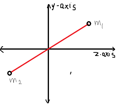

A rod of mass M and length l rotates in a vertical plane about its centre which is on a frictionless, horizontal pivot. On the ends of the rod are point-like masses m1 and m2, where m1 != m2.
a)moment of inerta about the center of the rod
b)Determine the angular momentum when the angular velocity is ω
c) Determine the angular acceleration when the rod makes an angle of θ with respect to the horizontal z-axis. For m1 > m2 what is the direction of the torque?
d) At what angle θ is the angular velocity ω the greatest?
So I would know how to do this question without the point masses m1 and m2, what they do is change the centre of mass of the rod, so does this question have something to do with the change in the centre of mass? Also what does it mean when the rod makes an angle of θ with respect to the horizontal, does this mean it is slanted?

So about my question in post #9?
when it is at an angle (theta ) then it is slanting to the z axis.
see the attachment
what significance does m1 > m2 have?
it is necessary for rotating the rod, for giving it angular acceleration.

Hmm this may be a dumb question but it says it is making an angle with the horizontal axis, but I[itex]\alpha[/itex] does not incorporate an angle, but T = r x F does, but then I am still stumped.
T = r x F
yes it is a cross product and needs the angle
τ=r*F*sinθ
τ is the magnitude of the torque,
r is the displacement vector (a vector from the point from which torque is measured to the point where force is applied),
F is the force vector,
θ is the angle between the force vector and the lever arm vector.

What is the force vector in this question? I don't know that.
the force due to point masses is the force vector here.It acts vertically downwards.
wait so that means that θ between the force vector and displacement vector is (90 - (horizontal angle))?
wait here force vector is the component of mg that is perpendicular to the rod
oh right right, so then θ is the actual horizontal angle. I am still kind of iffy on this concept, it is in 3-d, so the rod has been tilted to the horizontal axis, and is not spinning towards this horizontal axis, so I am not completely sure how you can use the angle with respect to the horizontal to get the perpendicular component of mg.
No. it's all in 2D, a vertical plane.
It doesn't matter whether the rod is rotating or not at this point. We just want to calculate the acceleration due to gravity when it's at angle theta to the horizontal. What torques do the gravitational forces on the different masses exert about the axis? How do they combine to a net torque?
