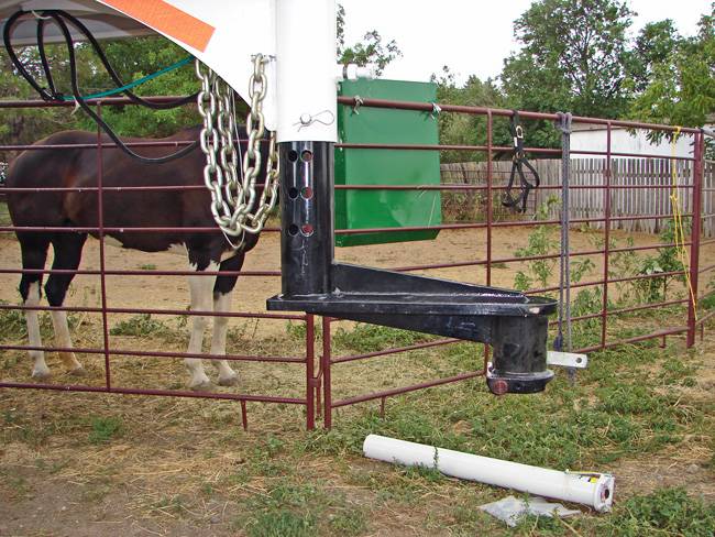

There is one point, between the trailer and the tow vehicle, where it can bend. That is the hitch point. You said that is fixed on the tow vehicle.
But the hitch point is being moved on the trailer. In effect, you are lengthening the gooseneck by 20".
The distance between the hitch point and the axles on the trailer is being increased.

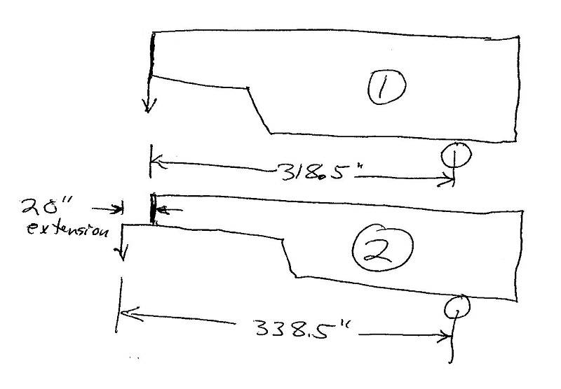

My experience is with fifth wheels on semitrailers. It does not matter what type of hitch is employed, the hitch is the hinge point of the combination of tractor and trailer.
The gross weight of the trailer and load can be seen as two parts. The first part is carried by, and balanced about, the trailer axle set. That offers no static load to the tractor hitch point.
The second part is the unbalanced mass that provides a moment, that rests effectively on the hitch. That moment is 2500 lbs at the old hitch position, 318.5" from the axle-set, which works out at;
318.5" * 2,500 lbs = 796,250 inch⋅pounds
If you extend the trailer axle-set to hitch point length by 20", the length becomes 338.5", so the vertical load on the tractor hitch will become;
796,250 / 338.5 = 2,352 lbs, which is 148 lbs less than the original.

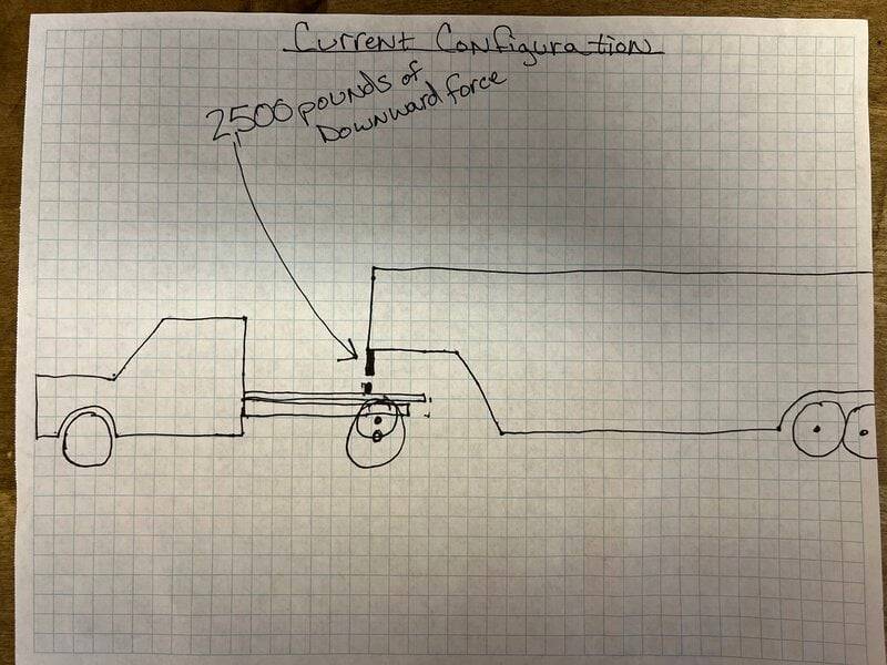

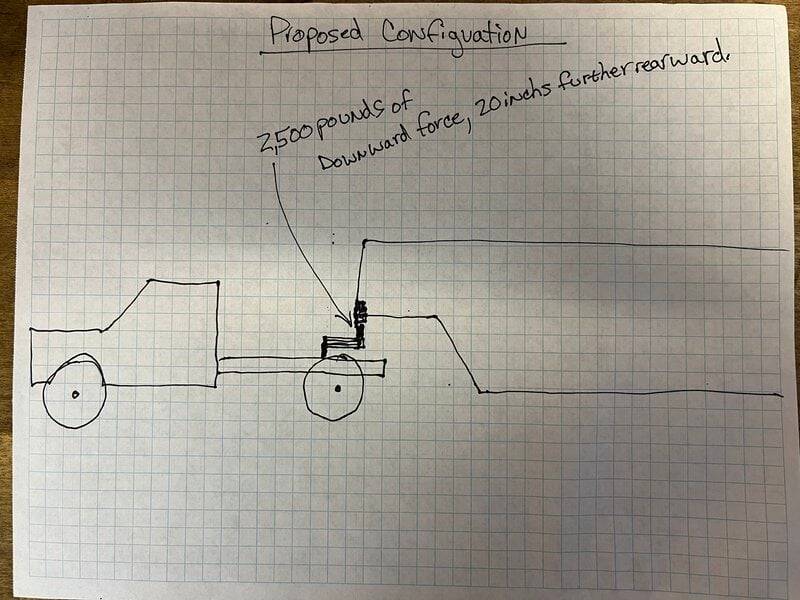

My understanding of the problem. The trailer wheels are not moved. The only change is a 20" extension that moves the hitch point 20" farther from the wheels. The load is not changed between the two cases. The total weight of the trailer does not change, except for a small additional weight from the welded extension.
If my understanding listed and shown above is correct, then @Baluncore's calculation in Post #38 and quoted below, is completely correct. Since the total weight does not change, the weight on the wheels will increase by 148 lbs with the 20" extension.
He calculated the tongue load moment in his first calculation. A moment is a force times a distance. In this case, the force is the tongue load in Case 1 and the distance is the distance from the center of the pin to the center of the axle. When you change the distance from the tongue force to the axle, the moment does not change. In his second calculation he takes the same moment and the longer distance, and finds the new tongue load.

Seems like two different things are being discussed:
jeredpilot said:
Current Configuration
Proposed Configuration
For the above modification, the vertical force at the arrow location doesn't change. But you get a moment transmitted where the dark connector attaches to the rest of the truck.
jrmichler said:
For this modification, the vertical force at the vertical arrow location does change (decreases). But you get a moment transmitted by the extension where it attaches to the trailer (thick front wall).

Is it what you have in mind similar to this?
Copied from:
https://mrtrailer.com/poptour.htm
