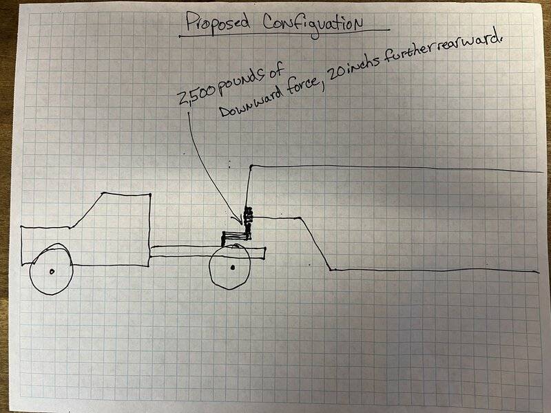

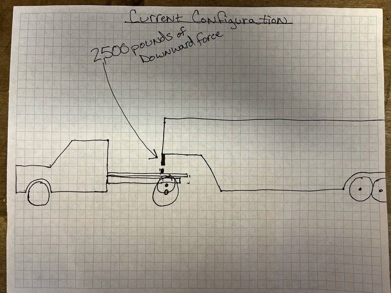

However, for certain reasons I must move the gooseneck trailer connection point rearward 20 inches. The hitch itself (permanently attached to the vehicle) will remain in its properly located position. I will build a hitch extension that displaces the hitch load point rearward 20 inches. This extension will not be in contact at any point with the vehicle other than to the hitch itself and the trailer when connected. So I am moving the 2,500 pound load from directly above the hitch to 20 inches rearward of the hitch.
So, what I need is the formula to calculate what the load on the hitch will be when the load is displaced rearward 20 inches. Is it simply 1.67 times 2,500 pounds which would be 4,166 pounds? (20/12*2500)
Also, I realize there will now be a ‘twisting’ force on the hitch itself. Is that twisting force equal to the new load? How would I calculate this twisting force?
Also, what is the correct terminology to properly describe my problem? This 20 inch extension is a sort of lever. And also this hitch extension acts like a cantilever beam of sorts. I’ve looked and looked for the proper terms to describe my problem, but as yet I am unsure what is correct.

I disagree on all points, but I certainly may be incorrect. (Due to not understanding each other)
Drawings incoming in a few minutes.
Current Configuration
Proposed Configuration

I assume the 20" is a rigid extension of the trailer gooseneck.
What is the distance between the hitch point now, and the mid-point of the tandem axle set?
Yes. It is rigid.
Length from the trailer connection point to the center of the axles does not change in either configuration. That length is 318.5 inches.

Rather than an extension of "the trailer gooseneck", I would say it is an extension of the hitch. Is that just semantics? Or does it make a difference?
It is critical.
Your diagram of the trailer does not show the position of the hitch, on the trailer now.

Correct me here if I am wrong, please.
But in my mind, if the trailer itself is never changed, and the weight of the downward force of the trailer never changes, then how does the distance of the axles come into play?
To me, if the trailer length never changes and the downward weight never changes, then the trailer axle position is irrelevant? The only thing that changes is the effective position where the trailer connect to the vehicle. Therefore, the trailer axle position is irrelevant? No?

The hitch is exactly at the front of the trailer. The very most front of the trailer.
jeredpilot said:
Yes. It is rigid.
318.5 inches
NO. The effect of moving the hitch point forward by 20" on the rigid trailer assembly, is proportional to the initial length of the trailer.
The fulcrum of the lever is the mid-point of the tandem axle set.
The effective load on the hitch will be reduced when the distance between the hitch and the axle set is increased.

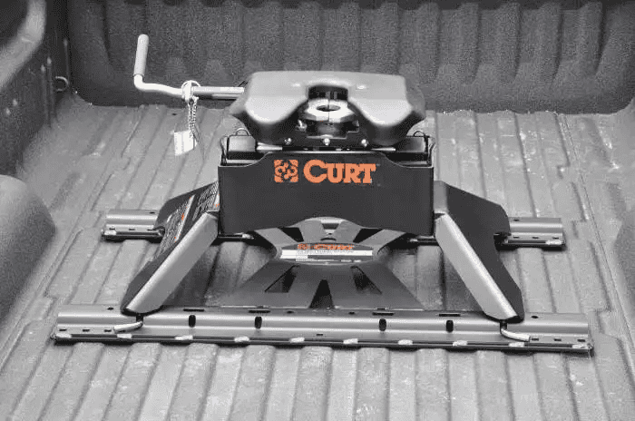

What does the term gooseneck mean to you?
Gooseneck Hitch:
Fifth-Wheel Hitch (same as tractor-trailer semi truck):

But the hitch point is being moved back, not forward.
So the hitch stays fixed, but the ball is moved back 20 inches. So the distance to the hitch itself grows by 20 inches. Since the extension piece is a rigid 20 inches, the length of the trailer increases. I get that. But and effective increased trailer length would add weight to the connection, not reduce it. (???)

Moving axles rearward adds weigh to the hitch - every single time.
Moving axles forward, lessens weight on a hitch - every single time.
jeredpilot said:
I am answering every question and trying to understand.
@Baluncore Is this controversial?
If we place the axles at the very rear of a trailer then the axles are further from the mid balancing point. So since we are moving them to the extreme rear and away from the balancing point, the weight on the hitch increases.
If we place the axles perfectly at the balancing point, then there is no weight on the hitch.
The axles remain fixed to the trailer, they do not move relative to the gross trailer centre of mass. Why do you now discuss moving them?

Maybe this was a typo by you, and thus why I am having difficulty following. But you said this in post number 18.
"The effective load on the hitch will be reduced when the distance between the hitch and the axle set is increased."
