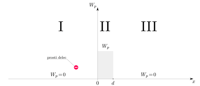

Lets say we have a tunelling problem in the picture, where ##W_p## is a finite potential step:
If particle is coming from the left a general solutions to the Schrödinger equations for sepparate intervals I, II and II are:

Where ##\psi_{in}## is an incomming wave, ##\psi_{re}## is a reflected wave and ##\psi_{tr}## is transmitted wave. I used the boundary conditions and got a system of 4 equations:

It accured to me that if out of 4 system equations i can get amplitude ratio ##E/A##, i can calculate ##T## quite easy. Could anyone show me how do i get this ratio?
