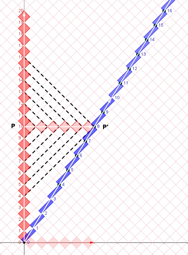

Let's decorate my earlier diagrams with radar experiments.
Inertial-observer Alice assigns coordinates to event ##P'##
using light-signals sent at ##t_s=4## and received at ##t_r=16## according to her wristwatch.
So,
##\Delta t_{P'}=(16+4)/2=10## and ##\Delta x_{P'}=(16-4)/2=6##:
that is ##(t,x)=(10,6)##, as you can count-off using Alice's diamonds.
Note that for all events E on ##PP'##, we have ##t_E=10## according to Alice.
(Consider the event that is radar-measured by ##t_r=13## and ##t_s=7##.)
So, ##PP'## is a line segment of simultaneous events according to Alice,
and is in fact simultaneous with local event ##P=(10,0)##, the midpoint of ##(16,0)## and ##(4,0)##.
(Note that ##PP'## is parallel to "Alice's stick", the spacelike diagonal of Alice's diamonds.)

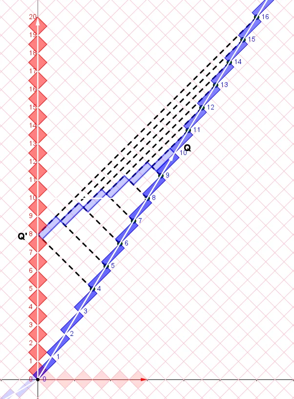

What about Bob, another inertial observer who met Alice
at event O, when both had their wristwatches read 0?
(I'm not going to worry about issues concerning the the positive-x axis, the forward and backward spatial directions of the radar signals, and the appropriate sign to assign for the spatial-displacement.)
[I am swapping Alice and Bob , and swapping Ps and Qs.]
Inertial-observer Bob assigns coordinates to event ##Q'##
using light-signals sent at ##t_s=4## and received at ##t_r=16## according to his wristwatch.
So,
##\Delta t_{Q'}=(16+4)/2=10## and ##\Delta x_{Q'}=(16-4)/2=6##:
that is ##(t,x)=(10,6)##, as you can count-off using Bob's diamonds.
Note that for all events E on ##QQ'##, we have ##t_E=10## according to Bob.
So, ##QQ'## is a line segment of simultaneous events according to Bob,
and is in fact simultaneous with local event ##Q=(10,0)##, the midpoint of ##(16,0)## and ##(4,0)##.
(Note that ##QQ'## is parallel to "Bob's stick", the spacelike diagonal of Bob's diamonds.)
So, with these constructions, we have:
##PP'## is simultaneous according to Alice, but not to Bob, and
##QQ'## is simultaneous according to Bob, but not to Alice.

robphy said:
(e.g. the set of events that transform to a constant-value of t for an inertial observer).
If I had an "a-ha" moment for special relativity, it was after learning General Relativity. Specifically chapter 8 in Wald on causal structure. It helps me immensely to think of things in coordinate invariant ways. Thinking in this way, the relativity of simultaneity of SR becomes a consequence of the light cone structure. Time-like or null separated events can not be be made simultaneous via any Lorentz transformation while space-like separated events can (in a globally Minkowski spacetime).
Reply
