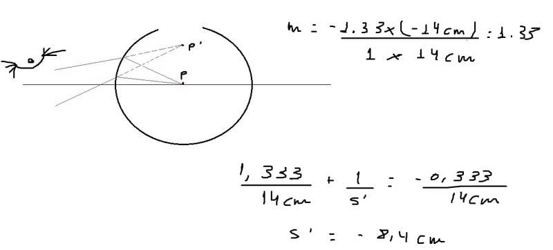

It would be like this?
but yet, I don't understand why the focal point is o
I am not convinced with the equation you've written at the bottom of that page
That diagram makes no sense. You show P as at the centre of the sphere. An observer will always see the centre of the sphere as being on a straight line with the centre, not at some point P' off to the side.

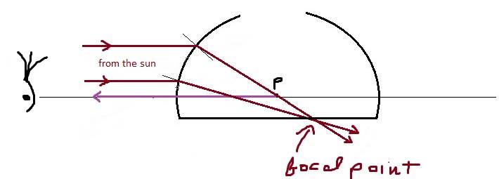

Oh thanks. I think because Engl is not my first language, I didn't know what is the actual shape of a bowl. I draw a new sketch where P and P' are in the same place and the focal point is outside the bowl.
You've drawn it as though P lies on the diameter that aligns with the observer, and the focal point is not on that. Is that what you intended?
Yes. Is there any problem with this?

Reread what I wrote in post #13. If you take a straight line from the observer through the centre of the sphere then the focal point for that observer must lie on that line. All points actually on the line will be seen as being on that line. Magnification consists of points off that line being seen as further from the line than they are.

A standard lens has its own axis. The focal point is taken as being on that axis because we base it on rays arriving parallel to that axis.
A sphere has no such natural axis. The focal point will depend on the direction your parallel rays come from.
In your diagram in post #14, point P appears to be the centre of the sphere, so the axis must pass through this point. You show rays from the sun arriving horizontally, so the focal point they converge to must be on the horizontal line through P.
Draw a horizontal line arriving above the axis. At entry to the sphere it will be refracted downwards, intersecting the axis at the focal point.

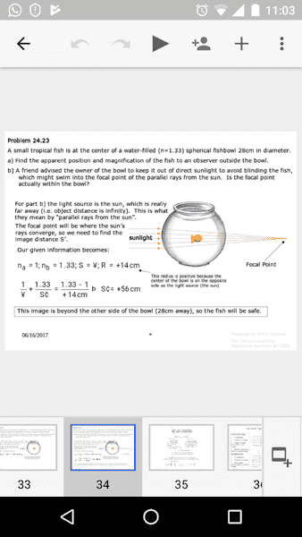

Here's the answer you'll need guys.
