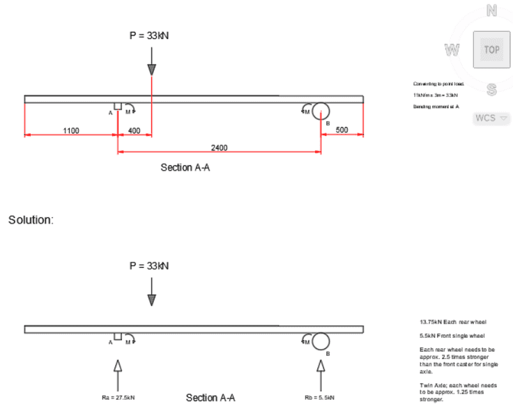

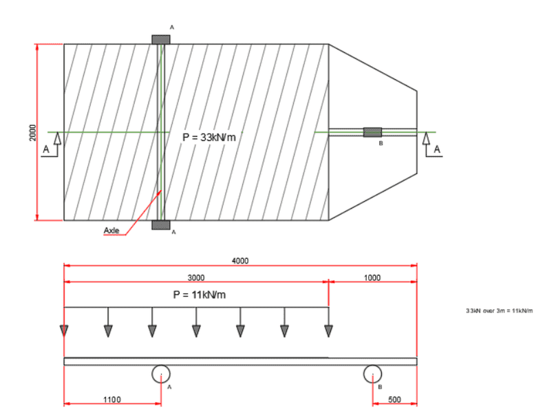

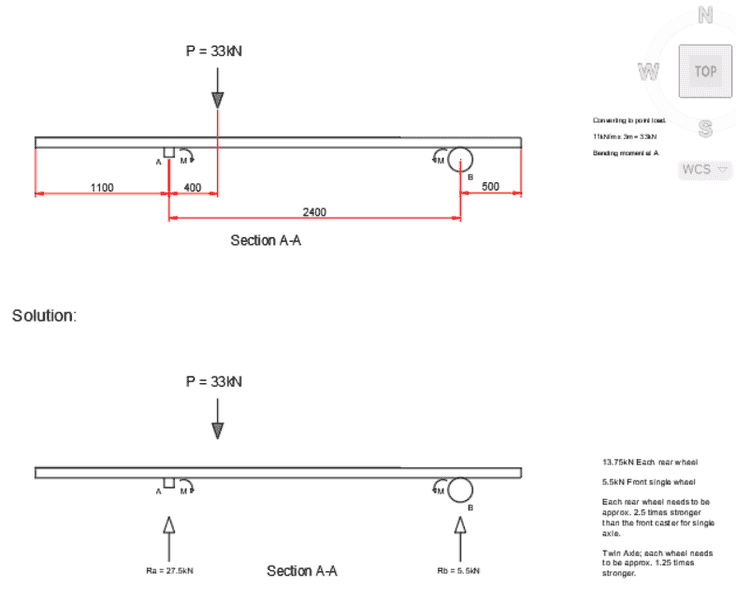

The problem is a trailer with 2 wheels at the back and one at the front. I used statics to find the reaction force for each axle. The front comes in at 5.5kN. The G force then if hitting a bump I'm setting to 3 gs. 5.5kN * 3 = 16.5kN maximum load at the front axle.
The spring and shock being looked at is <400mm in length and can be any other variable.
So far all attempts at getting a realistic answer have not worked out, seems that the load 16.5kN is way too much and the even 5.5kN seems unrealistic for finding stock springs. Looks like I'm doing something wrong?
Static equation below:

If you are trying to design a suspension for a vehicle, the better approach is to define a speed and a bump, then design the suspension to absorb that bump with a defined peak displacement or peak acceleration of the vehicle. A very quick Google search using the terms road vehicle acceleration bumps came up with this: http://www.archiwummotoryzacji.pl/images/AM/vol67/vol67-janczur-en-47-60.pdf. When designing a suspension, the peak acceleration of your vehicle is the result of a speed and a bump, not an input.
Your wheel load is roughly comparable to that of an American full size pickup truck. Take a look at some large cars or trucks to get an idea of the sizes of spring used, then measure up a few springs, and calculate their spring constants. That will give you a starting point and a sanity check.
