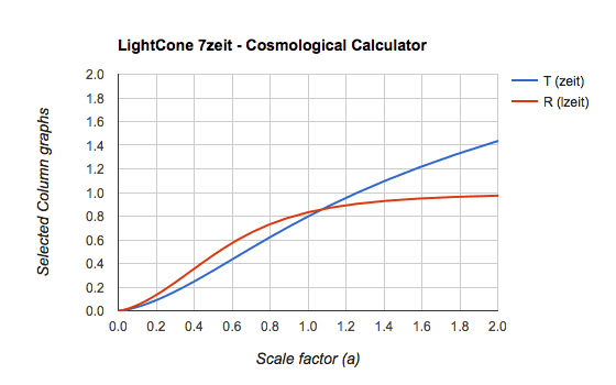

DAH, I would suggest the two curves are not closely matched and just had to cross somewhere. They will cross exactly at some point in the future and then get farther and farther apart.
Here the x-coordinate is the size of distances compared with their present size, so it can substitute for a time coordinate. T is the age of the expansion (or "age of universe") and R = 1/H is the Hubble time. The units are chosen so that in the long term the Hubble time approaches 1 (1 zeit = 17.3 billion years)
http://www.einsteins-theory-of-relativity-4engineers.com/LightCone7z/LightConeZ.html
Here's the same plot with vertical scale in billions of years:
According to the best fit cosmic model the exact equality of T = 1/H will occur in only a little more than a billion years from now.
IOW for most of the history of the universe 1/H is a bad estimator of the age. There is no physical reason it should be a good estimator. But a clock has to be right ONCE and just by coincidence this is slated to happen some time in the near future . We can even say when it will happen.
Assuming recent measurements of cosmological parameters, it will happen right around year 14.856 billion.
Roughly speaking the exact coincidence will occur in about 1 billion years from now. A little over a billion. But so far we don't know the parameters with such precision that one can be much more definite than that.
[tex]{\scriptsize\begin{array}{|c|c|c|c|c|c|}\hline R_{0} (Gly) & R_{\infty} (Gly) & S_{eq} & H_{0} & \Omega_\Lambda & \Omega_m\\ \hline 14.4&17.3&3400&67.9&0.693&0.307\\ \hline \end{array}}[/tex] [tex]{\scriptsize\begin{array}{|r|r|r|r|r|r|r|r|r|r|r|r|r|r|r|r|} \hline a=1/S&S&T (Gy)&R (Gly) \\ \hline 1.07573&0.92960&14.85538&14.85570\\ \hline 1.07574&0.92959&14.85553&14.85571\\ \hline 1.07575&0.92959&14.85568&14.85573\\ \hline 1.07575&0.92958&14.85582&14.85575\\ \hline 1.07576&0.92957&14.85597&14.85576\\ \hline 1.07577&0.92957&14.85612&14.85578\\ \hline 1.07578&0.92956&14.85627&14.85580\\ \hline 1.07579&0.92955&14.85642&14.85581\\ \hline \end{array}}[/tex]
You can see that with this choice of model parameters the crossing of the curves happens when the scale factor is 1.07575. that is, when distances will be about 7 and 1/2% larger than they are now.
Around that time the "age of the universe" will be something like 14.8557 Gy and the Hubble distance will change from being slightly more than the age, to slightly less.
But it seems pointless to note that because there is no logical connection. Hubble R is not a good estimator of age T, and it's simply a coincidence (according to standard cosmic model) that they should be approaching a crossover point and temporarily be roughly similar in size.
table by Lightcone:
http://www.einsteins-theory-of-relativity-4engineers.com/LightCone7/LightCone.html
