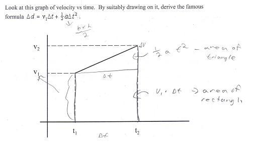

See the attachment please.
I know the v1 x delta (t) is for the rectangle,
I don't see how the second part works? I don't understand why the t^2 and how a replaces the area formula i have written.
Thanks for your help, its my first day of class today, and its been a while since i was last in a physics / math class.

You can replace [itex]\Delta v = v_2 - v_1[/itex] by the acceleration a. In the picture, the acceleration is the slope of the line, algebraically it is given by
[tex]a = \frac{\Delta v}{\Delta t}[/tex].
So just write down the area of the triangle and do the substitution.
from the second equation on the formula sheet,
a=[tex]\Delta[/tex]v/[tex]\Delta[/tex]t
a=(vf-vi)/t
from the graph, d=vit+[tex]\frac{1}{2}[/tex](vf-vi)*t
therefore, d=vit+[tex]\frac{1}{2}[/tex]at2
(since vf-vi=at)
