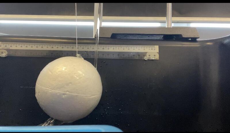

I am a high school student writing a 4000 word research paper on Bernoulli's principle and coanda effect. In the experiment set-up shown here
a sphere made of Styrofoam is suspended in the air next to the tap. When the tap is turned on, the sphere gets 'attracted' towards the jet stream and the water starts to flow along the curvature of the sphere. For my experiment, I am trying to derive a formula that connects the flow rate of water and the distance moved by the sphere i.e., How does the varying flow rate of water affect the distance moved by the sphere.
I am not entirely sure how I can create a Freebody diagram which can help me create an equation. From my research so far, I understand that the sphere moves towards the jet-stream of water due to the difference in pressure (relatively higher air pressure on the outer side of the sphere and lower pressure where the sphere comes in contact with the water). Does this mean force of air plays a huge role in the equation?
So far, I found the document attached below which has an experiment in page 55 which is kind of similar to mine. It has a derivation to obtain the force acting on a cylindrical object but I am not entirely sure of how to use it. For anyone who is interested in this document, I translated it to English using google translate here.
Can someone please help me with the derivation of the formula that connects these 2 variables please (distance moved by the sphere and the flow rate of water). I am hoping to obtain a linear equation at the end. It is alright if the derivation requires math that is much more complicated than high school math as we are expected to go way beyond our syllabus.

Yea, I am able to analyse that data roughly using the recorded videos of each trial. I have no idea how I can link flow rate and the deflected angle though

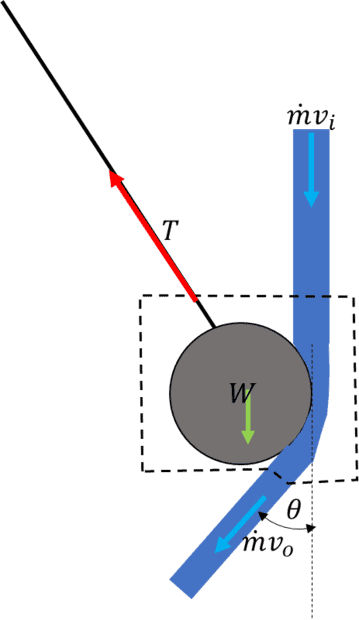

You are going to be working with a control volume that is something like this:
And you apply Reynolds Transport Theorem - "The Momentum Equation" in fluid mechanics.
Which says for steady flow with uniform velocity distribution (one inlet-one outlet):
$$ \sum \vec{F} = \dot m \vec{v_o} - \dot m \vec{v_i} $$

To get the solution in the paper assume uniformly distributed velocity, incompressible flow.
You will use continuity ##\dot m = \rho A_iv_i = \rho A_o v_o ##
I updated the diagram to specify a few more parameters and a coordinate system that makes the math less sign error prone:
You write the equation of motion I gave for the control volume in each coordinate direction ( two independent equations). You will be able to solve for ##\beta##.

@erobz I see a slight problem, I can count 3 equations (together with continuity) and 4 unknowns , the two angles, the magnitude of tension and the magnitude of ##v_o##. Unless we take ##|\vec{v_o}|=|\vec{v_i}|## as assumption.
My line of thinking is they are measuring ##\theta##, controlling ##\dot m## and measuring/estimating ##A_i,A_o##. Weight is measured.
As far as I can tell I'm left with two equations two unknows ##T,\beta##?

Hi, which equation of motion are you referring to? From What I understand about Reynold's transport theorem so far, is it correct to conclude that the column of water until the water comes in contact with the sphere is system and the water that gets deflected is control volume?
Reynolds Transport simplifies ( or can simplify under certain assumptions) to the equation at the bottom of post #5.

Yeah, What I mean is the equation applies in each coordinate direction independently. The coordinates are labeled ##\hat i,\hat j ## in the diagram in post #13. Don't forget about the external forces, they are vectors too.

No, the control volume completely surrounds the system. It is atmospheric pressure the whole way around its boundary, with the possible exception (under a microscopic precision) of the tiny areas where the flow enters and exits the control volume. I think the deviation from atmospheric pressure inside this flow stream is miniscule at worst, and incalculable at best.
