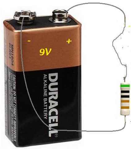

So, the Wiki page on the Poynting vector has this image:
I remember hearing/reading somewhere that the energy transmission in a circuit like this is actually not traveling through the wire, but that it actually happens through the electromagnetic field, I.e. essentially the Poynting vectors.
At the same time, I feel this is too wild a claim given how something like Ohm resistance is due to "pushed" electrons bouncing against atoms.
So, is this a mixed influence, or is the usual analysis of circuits just a convenient, but eventually inaccurate way of looking at things?

I wouldn't say that circuit analysis is inaccurate. It is based on certain simplifying assumptions, but as long as those assumptions are met it is accurate.
The problem is that people read too much into it. Circuit theory describes how much energy is transferred, but it never makes any claim about where energy is located within a circuit element nor where energy crosses a lumped element's boundary. There is no conflict here because circuit theory makes no claim on the question.
Likes hutchphd, anorlunda and LLT71
So, what is the role of the wires, if not the means of energy transmission? Is it simply creating the field which then transmits the energy straight from the battery?
Yes. In particular, it contains the currents which are the source of the magnetic field.

The potential difference between the conductive wires guides the electric field.
The currents that flows along the conductive wires guide the magnetic field.
The cross product of the electric and magnetic fields gives the Poynting vector = energy flow.
The product of the voltage and the current gives the rate of energy flow = power towards the load.
The resistance of the wires, multiplied by the square of the current that is needed to guide the magnetic field, results in a loss of energy along the wires before that energy can reach the load.
