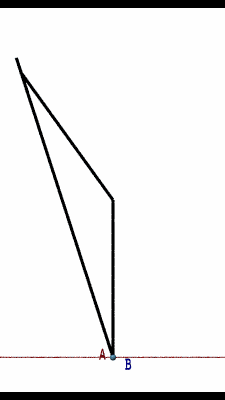

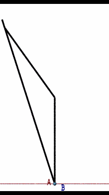

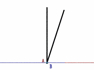

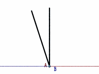

This is a common question. The problem come from thinking about Relativity in terms of something that "causes" clocks to slow down. It is more about the very natures of "time" and "space" and how we measure them.
To explain what I mean, I'll use an analogy. Imagine time and space like a map. North and South is time and East and West are space. If you take two points on that map, they will have a set North-South and East-West relationship to each other. I can turn the map in any direction I like and this relationship doesn't change, as it is tied to the map itself.
This is how time and space were thought of prior to Relativity. What Relativity changes is the relationship time and space has to the map. Now instead of being tied to the map, it is tied to the Observer. Space is measured by the Observer's Left-Right and time by the Observer's Up-down. Now if I turn the map with those two points on it, their Up-down and Left-right relationships change. I can turn the map until the one point is right above the other, or so that neither point is above the other. The same thing happens leave the map where it is and rotate myself instead. My sense of Left-Right and Up-Down turns with me.
So let's consider how that works when dealing with the Twin paradox. This time we are going to use a really big map and put our observers on it. We'll leave Left-right as being space, but now front-back for each observer is time.
We'll have two observers (A and B) and start them off at the same pace from the same point.
Here's how things appear to A.
The red line represents progress in the direction he is walking (which in this analogy represents progress in time). As you can see, By A's reckoning, he progresses through time faster than B. (he ages faster)
If we switch to B's perspective we get this:
According to him, he is the one that makes better progress through time and thus ages the faster of the two.
Unless something changes, this will remain the case. In the Twin paradox, something does change, one of the twin changes his velocity and heads back toward the other twin. In our analogy, this is the equivalent of one of our observer's changing direction and walking back towards the path of the other observer. We'll choose B for our analogy.
Thus from A's perspective, we see this.
Even after B makes his turn he continues to make less progress in time an age slower than A does. When he crosses A's path, he is directly "behind" A in time but in the same spot in space (measured left and right). Thus in the twin paradox, according to A, B ages more slowing than he does during the whole trip and when they reunite has aged less.
What happens according to B?
If we just take our first view for B and extend it we get this
B, after changing direction starts to make slower progress than A. A catches and passes B, and B ends up being behind A. A still ends up aging more than B.
But this isn't exactly what happens according to B, But rather what would happen according to some one who continued in B's original direction after B changed directions.
For what happens according to B, we have to consider what I said above about what happens if we turn the map or turn relative to the map. When B changes direction, so does his relationship relative to A does in terms of time.
What happens is this:
B starts out heading "straight up". After he changes direction he still is heading "straight up" (by his perception he is still walking "forward", so the whole "map" has to rotate. But when this happens, A goes suddenly from being "behind" B to being "ahead" of B. B then starts to catch up, but never does before A crosses its path.
So even though at no time does A or B change the pace at which they walk, B ends up "behind" A
B took a different path in space-time, and as a result, spent less time by his clock doing so than A did.
The important thing to keep in mind is that in these animations the Up and Down directions are measurements of personal time, and the left and right directions are space(limited to one dimension in space.)

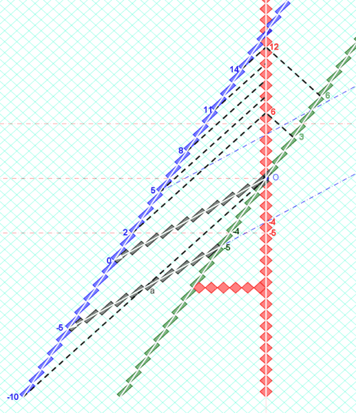

Sorcerer said:
An attempt at your “show the math” request. This is the same problem worked out in the Scientific American thread, with a different gamma.
One twin, A, stays on Earth. The other twin, B, accelerates at a very, very tiny rate (so that acceleration is irrelevant) until he reaches 0.7c. Note: we can accelerate as slowly as we want so, again, reaching the initial speed is irrelevant.
Twin B will travel to a planet that is 7 light years away according to measurements taken at rest with respect to Earth (i.e. this is the distance A measures).
Due to length contraction, as Twin B travels, to him the distance appears to be 5 light years. Thus, traveling at 0.7c, Twin B gets there in 5/.7 = 7.14 years (approximately).
Meanwhile, Twin A sees Twin B reach the planet in (7/.7 + 7) years = 17 years (7/.7 for the actual travel time of Twin B and 7 more years for light to reach Twin A after Twin B arrives). Thus, to Twin A, Twin B’s clock appesrs to be running 7.14/17 = 42% the normal rate.
Both get different times, but both see the other as ticking at the same slowed rate.Now look what happens on the way back. Since according to Earth the total distance is 14 light years, and since the spaceship traveled at 0.7c, the total trip must take 20 years. But 17 were spent on the way there according to Twin A. Thus, according to Twin A, the remaining trip must take 3 years. Thus, on the way back Twin A sees Twin B’s clock tick 7.14 years in only 3 year’s time. So now Twin B’s clock is ticking 2.38 times faster for 3 years.
Meanwhile, Twin B has a total trip time of 14.28 years, and 7.14 years remaining. But by the time Twin B gets to the planet, according to Twin B, 3 years have passed for Twin A. Since the total trip according to Twin A must be 20 years, Twin B must see 17 years tick on Twin A’s clock while only 7.14 tics on his own clock. Thus, Twin B sees Twin A’s clock tick at 17/7.14 = 2.38 times the rate of his own clock, this time for 17 years.
Thus you see the symmetry and asymmetry for each twin. The “moving” twin sees the other twin’s clock tick faster for longer. By the time the reunite, Twin B will be younger than Twin A.
No dependence upon acceleration other than to turn Twin B around so he returns home.
That’s my take on it, anyway. I’m sure someone else has something better.
It appears that you are using the Doppler shift explanation here. But it is a bit muddled. For example, when you say
When Twin B reaches the planet, he sees Twin A’s clock as it was 7 years ago, which means 10-7 = 3 years have passed for Twin A according to Twin B. So according to Twin B, Twin A’s clock is 3/7.14 = 42% the rate of Twin B’s clock.
You are talking about what B sees, but you are working in the frame of A. In B's frame, he doesn't see A as it was 7 years ago, but as it was 3 years ago by his clock. (according to B, that's how far apart A and B was when the light left A) You also say, that that 3 years have passed for A according to B. But three years is the reading on Clock A that Clock B visually sees at that moment, and not the actual time on Clock A according to B at that moment (which is 5 years).
You also claim that acceleration is not important to this scenario, but it is. As A watches B recede, he sees B's clock run slow until he sees B do his turn around and then he sees B clock run fast. But there is a 7 year lag between B actually turning around and B turning around, Thus he sees B's clock run slow for 17 years and fast for 3 years. B however sees A's clock run slow for 7.14 years and fast for 7.14 years. This is because he sees an instant shift in the Doppler shift from A when he turns around. In other words, because he was the one that underwent an acceleration, he sees that instant change in Doppler shift, while A, who doesn't accelerate, has to wait to see the effects of B changing velocity.
What I meant by acceleration isn’t important is that it is only the cause of the asymmetry, but it the asymmetry that ultimately causes the difference. Is that a fair statement?

SiennaTheGr8 said:
I think David Morin does a nice job covering the relativity of simultaneity. In particular, I like that he names the "rear clock ahead" phenomenon (see p. 11 of this PDF).
Here's a seemingly bizarre consequence of the "rear clock ahead" effect that Don Koks points out:
Source: https://books.google.com/books?id=ytTFazXPy6oC&pg=PA233
That's what happens in the twin paradox when the rocket-twin changes directions: Earth-twin's clock switches from being the "front clock" to the "rear clock" (in relation to a synchronized clock at the turnaround point). For the rocket-twin, it's like the Earth-twin has suddenly "jumped ahead" very far into the future, but really it's the rocket-twin who's made a sudden change.
Why would the clock run slower when it is moving away and faster when it is coming back?
If it does what happens to a long object as it passes the return point and it has one clock running fast and the other more slowly as it passes?
There is no actual change in the behavior of the clock itself, we're talking about how it LOOKS to the observers.
Yes, the time we measure on the distant clock really is swinging back and forth wildly, as we accelerate periodically to switch our walking direction.
Does this claim of "wild" play on an emotion? This wild swinging is nothing but a notion of simultaneity swinging, there's nothing physical in that, so in that sense it's not wild.
When you say LOOKS do you mean it's not real?
It's completely real to the looker, it's just not real in the frame of reference of the clocks.
