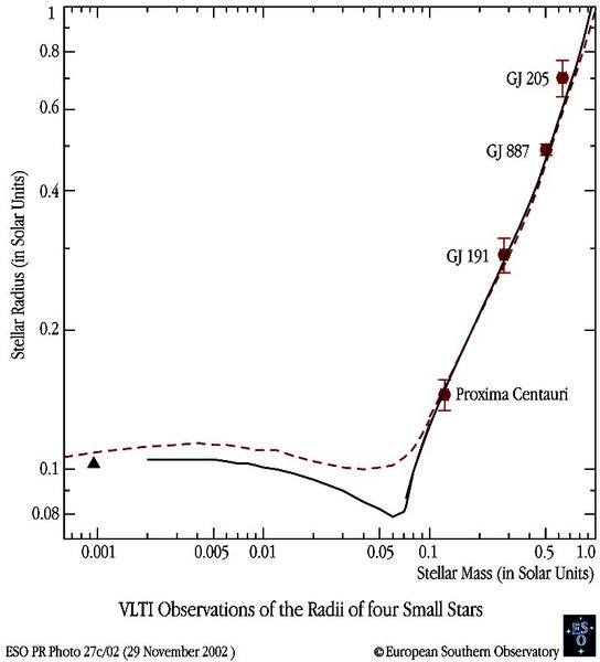

Brown dwarfs, especially older ones, are typically smaller than Jupiter. Young ones can be a tiny bit larger, but not much. Here's a nice plot from the scholarpedia article on brown dwarfs (http://www.scholarpedia.org/article/Brown_dwarfs):
The black triangle near the lower right: That's Jupiter. The other labeled objects are red dwarfs. The dashed red curve is a model of objects at an age of 400 million years. The solid black curve, an age of five billion years. The low point on the black curve corresponds to density of over 200 g/cm3.
