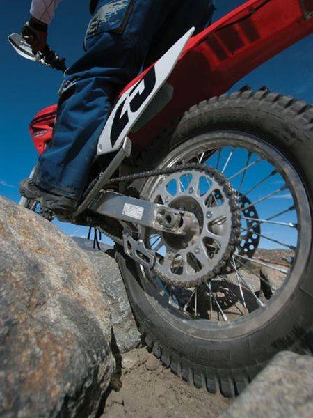

Yes, energy is lost in the continuous deformation of the underinflated tire as it rotates. It has nothing to do with the friction between the tire and the road. Have you been able to start understanding this effect now because of the responses in the thread? :smile:
https://www.physicsforums.com/threads/awesome-motorbike-skills.937405/#post-5928180
Low-angle photo of a red dirt bike's rear wheel and chain sprocket on a rocky surface, with a rider's blue-trousered leg and boot resting on the footpeg.
EDIT/ADD -- Bonus Quiz Question related to the question in your first post -- Why is underinflating tires good for climbing over rocks or riding/driving through sand? :smile:
