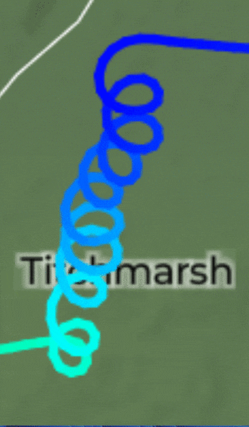

I help run, score and analyse flights at gliding competitions. I can examine 30 - 60 flight recorder traces per day for up to ten days (weather dependent sport) and can show you exactly what the track over the ground looks like. Airspeed once in the thermal will be kept constant as will angle of bank, to stay in the thermal - bubble of rising air - but ground speed will vary as you got round the circle in the air, producing the sort of thing you see in the image. I simply opened the first one I found, this is perfectly normal when examining the flight recorder traces. Glider are typically circling at about 50 knots in the thermal, some models of glider will be slower, some faster. On windy days the distortion to the circle can be quite significant, looking as if the glider charging along in one direct, then almost turning on the spot and repeating this for five to ten minutes as it gains height. In this image the gliders comes in from bottom left, turns and eventually leaves at top right. Wind is blowing from bottom to top in the image. Just walk yourself along the trace to see what is happening.

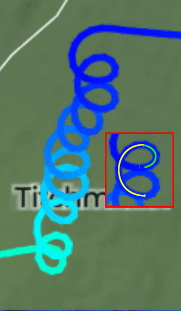

I see two curves here. One, the result of turning and flying with the wind (the yellow) and the other when turning and flying into the wind (green). Here are a couple of questions...
1. Are these two of the same kind of curve (for example, cycloid, if that is indeed what it is, or whatever) with different parameters?
2. Are these actually elipses (compressed circles) each with different major and minor axes? (I'm sorta leaning in that direction, by the way). And if and elipse, how would you go about determining the minor axis? One axis would have one end at the start of the turn and the other at the end of the turn. The other axis would depend on the relation of the wind direction to the turn, I guess.
The reason I want to know all of this is because my plan was to settle some arguments about holding patterns and wind corrections needed to fly the perfect holding pattern in wind. I was using autocad to draw it out when I realized this curve was an issue.

thetexan said:
Is it a cycloid, curtate cycloid, prolate cycloid or epicycloid.
Depends on the windspeed. But usually the windspeed is smaller than the airspeed of the plane, so it's a prolate cycloid:
You can divide it in as many parts you want. But under ideal conditions (perfect circles relative to a uniformly moving air-mass) it's all just one prolate cycloid.
Here is the curve in question. The center of the "wheel" travels along a straight path. The height of the curve is equal to the radius of the circle. The length of the curve is determined by the distance between the starting point of the curve (let's call it the 270 degree point on the circle) and the ending point of the curve (let's call it the 90 degree point on the circle).

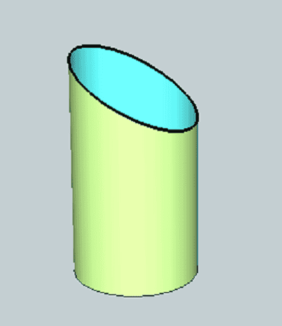

An ellipse may also be defined as a "conic section" -- the intersection of a plane with a circular cone.
It turns out that an ellipse is also the intersection of a plane with a right circular cylinder.
