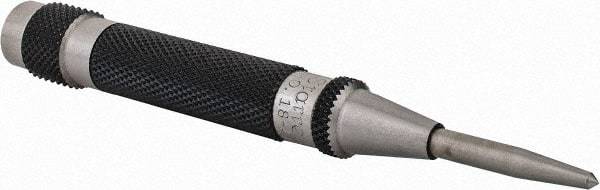

When I was a fire fighter, we carried small lightweight tools like this in our pockets.
It is very effective on the side windows that use tempered glass. The device you pictured probably uses the same principle.
Once the window is broken, it is easy to push the window tint film aside.

berkeman said:
+1 on anorlunda's tool. I've carried one for the last 10 years in EMS (only came close to using it once, though). Notice the blunt tip compared to a drill press center punch tool...
Here are the videos associated with the Rescume car escape tool. I haven't watched the videos, but I'm assuming they show how effective it is.
https://www.google.com/search?q=res...Bu4vfAhVZFTQIHQeMCX4Q_AUIDygC&biw=728&bih=585
The Resqme is based on spring system. If the spring unit broke.. it can't be used anymore. So maybe manual hammer is better than spring based?
The tool that @anorlunda and I have mentioned is also spring-activated. Have you ever used a center-punch tool to make a mark before drilling a hole in a material?
Are you going to start carrying a hammer or a crowbar in the passenger compartment of your car? You may have to explain yourself to any police officer who stops you for a traffic infraction... :smile:

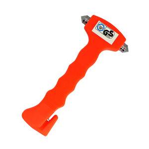

Whatever you get, I would make sure that it floats. If you end up in the water, you're going to be trying to breathe whatever air is available and it's pretty handy if the tool to break the window floats right up next to you at that time. :oldwink:
The side windows use tempered glass. The windshield is laminated glass. The conical tool won't work well on the windshield.
Also, broken tempered glass fragments are usually not sharp and won't cut you. Broken windshield shards are very sharp and can cut you to shreds. It is better to focus on the side windows for escape.
Auto rear window? I don't know what type of glass those are.
It is common to see videos of police trying to use nightsticks to break side windows, and they fail. I wonder why they don't put a conical point button on the butt end of the nightstick specifically for breaking car side windows.
I use a device like this. Conical window breaker, flashlight, seat belt cutter, all in one. (The hammer in #9 also includes a seat belt cutter.) No springs. With the conical point, you don't need to hit with great force to break the window. IMO, cutting the seat belts may be more difficult than breaking the window.

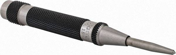

The previously mentioned spring type tools are very reliable and they work very well. Any of the side windows on your vehicle are tempered and they will come out in their entirety. Window films are a thin open polymer layer and they will tear free easily. One advantage is that tempered glass shatters with very few sharp edges. One can with a low level of risk just brush everything away by hand.
The orange hammer has the advantage that the plastic handle can brush away glass with significantly reduced risk. Also many of the modern vehicles have seat belt tensioners and locking mechanisms. These will often prevent you from releasing the latch. That little hook at the butt of the hammer is a shielded blade that can safely cut seat belt material. Advantage two, to the hammer.
As to the windshield (and some of the sedan rear windows) these are made of a laminated treated glass composite. They are quite strong and designed to dissipate impacts without total failure. If you happen to have the unfortunate situation of going into water the pressure outside even at very low submersion levels will usually prevent getting them out of the frame. The common tool of choice for emergency windshield removal is a Reciprocating saw with a Rescue tooth pattern.
Generally I like the punch and have carried one for many years. If you happen to come up on a need for one without your tool a great trick if available is to use the antennae. The old style whip radio antennas are a short metal wire with small (approx. 1.5 mm) ball tip. rip it off the car and a quick swing hitting the window with the ball will take out the window instantly. The only reason I take the punch as a tool is that I have gloves to handle glass and trauma shears to handle belts. The smaller lighter tool is less junk in my pocket. For General public use I have never seen a conscious person that was capable of self rescue that could not use their hammer device.
