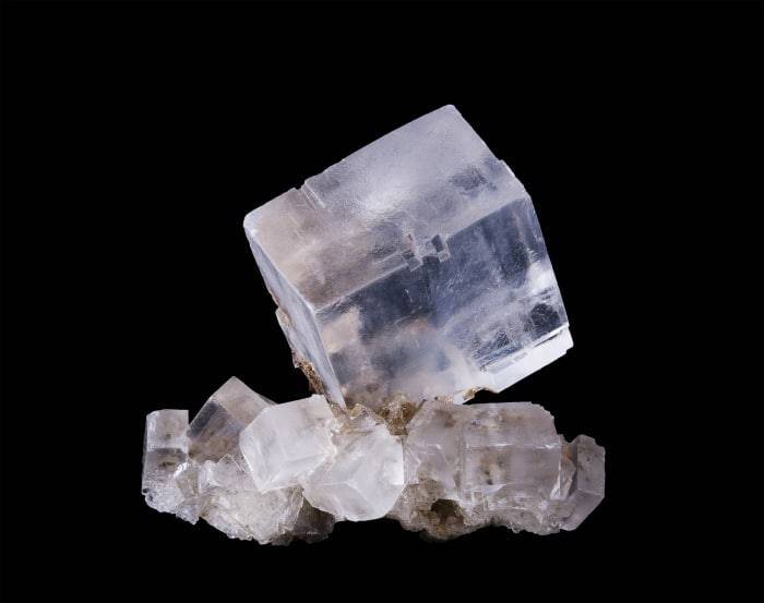

They are also many videos of simply throwing salt at the side windows and it breaks. What happens here?
Salt? Very interesting. I suspect that the salt, the porcelain the conical hammer, and the center punch all have two things in common --- a sharp point and hardness.
Salt crystals
I think this stretches my skepticism to breaking.
I will put my money on 'fake' until convinced otherwise.
Driving on winter roads, I have had salt hit my windows many times and it never broke any...
