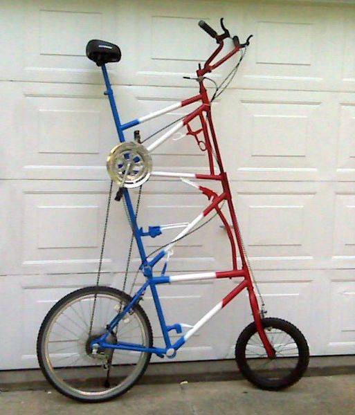

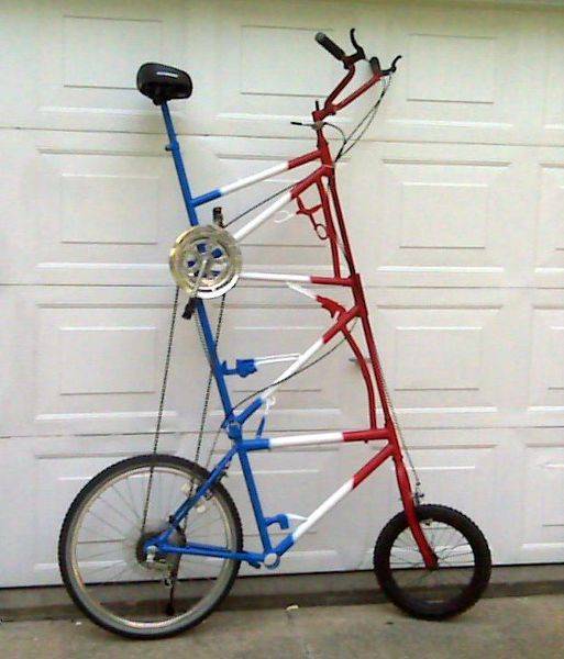

I’ve seen tall bikes here in Austin. They look awesome but I’d never try it because to me it’s an accident waiting to happen:

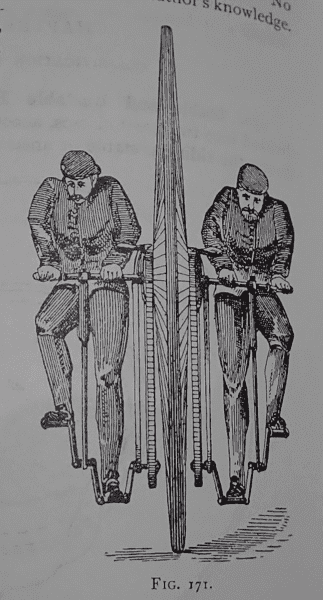

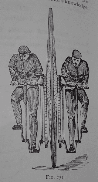

The unicycle (AKA sociable monocycle) in the figure below never became popular.
It's from Bicycles and Tricycles by Archibald Sharp and originally published in 1896. The book is still in print.
Turned by coordinated leaning? Seems like the big wheel would provide a lot of angular momentum making turning harder.
I guess but these things won't be known unless you've ridden one. It may well be that it only rides in a straight line.
One has to be old to get this but maybe a "floatilla" of these bikes will bring in the American Tricentennial. :)
There's a more fundamental problem. Checking this concept against the laws of physics, we see that the sociable monocycle gets its driving torque by moving the center of mass of the riders forward of the axle when they pedal. Notice that the center of gravity of the riders (roughly top of the hip bone) is only slightly below the axle centerline. When they step on the pedals, they will spin themselves around. If they accelerate slowly enough, they could ride on a level road, but that machine will never climb any significant hill.
Just because something made it into print, or even into a patent, does not mean that ever worked. When looking at new ideas or patents, it is always a good idea to check the concept against the laws of physics.
