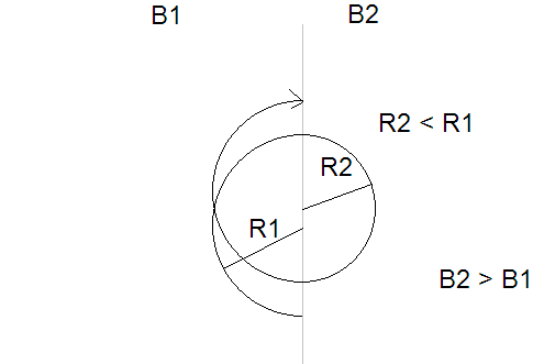

When considering an ionized medium (e.g. plasma) in nonuniform magnetic field, ##\vec{B}##, there will be a drift velocity for ions that goes in the direction of ##\frac{1}{q} \vec{B}\times\vec{\nabla} B ##: https://en.wikipedia.org/wiki/Guiding_center#Grad-B_drift
Although this implies the ion will be increasing its kinetic energy when entering a nonuniform magnetic field, for example if it's initially traveling perpendicular to this drift direction. Thus I am just curious as to where exactly energy is coming from and the mechanism by which this is occurring. Is the magnetic potential energy decreasing (as there is a gradient in the field) and being exchanged with the particle, thus leading to energy conservation? Is there a particular force typically attributed to this process? And in terms of photons being energy carriers (and the field being represented by creation/annihilation operators), is there an intuitive understanding as to how photons could mediate this process of producing a drift velocity on an ion when entering a magnetic field with non-zero gradient?
Assuming there is no E field, the kinetic energy of the ion doesn't change as it gyrates around the field lines. The velocity is moving in a circle, but the speed stays the same. What do you mean by "magnetic potential energy"?

The guiding center drift velocity is not an "additional" velocity. It comes a cycle average of the gyro orbit. All of the kinetic energy is accounted for in the gyro orbit.
To understand the grad B drift, consider that the gyro orbit radius depends on the magnetic field amplitude. Since the amplitude depends on position, you don't have circular orbits. If the magnetic field is higher on the left side, then the orbit is a distorted circle such that the right side covers a bigger arc than the left. The result is that the loop doesn't close on itself, and there is a small displacement after ever cycle.
The magnetic stored energy is not relevant to the grad B drift. There is another drift, the diagmagnetic drift, which does have an effect on the magnetic stored energy.

Perhaps I am missing something blatantly obvious and elementary, but in the derivation of this drift velocity due to the magnetic field's gradient, where is the (explicit or implied) constraint that the particle's kinetic energy is conserved? In the case of a uniform magnetic field, it is easy to see that the particle will be in a circular orbit where its speed remains constant (there is no potential difference), but that doesn't appear so obvious here as there is no longer simply uniform circular motion.
If you are only considering single particle motion (which is all that is needed to understand the grad-B drift), when E = 0, the Lorentz force doesn't do work, so the energy is conserved. In a magnetic mirror, there is a conversion between parallel kinetic energy and perpendicular kinetic energy, but the total energy doesn't change.
Here's a picture to go along with my explanation in post #6.
The picture and re-reading your post helped immensely. Thank you.
