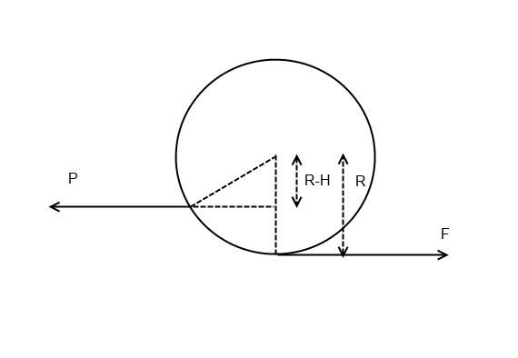

I suggest a drawing. In fact always do a drawing. I got a simpler answer with no trig functions.

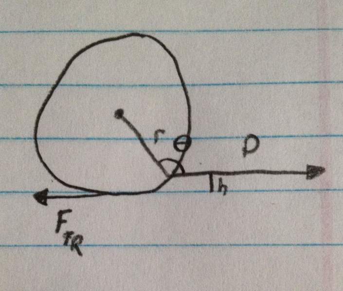

Here is the picture I have been using. Maybe I'm interpreting the problem wrong?
Edit: Oh! Just saw your picture. Taking a look at it now...
Edit2: To reach your solution, did you use the same method, however? Rather, is my next step to find a way to rewrite the sinθ in terms of R and H or should I rethink my process?

Yes, try to write sinθ in terms of H and R. And check the signs of the torques -that of the applied force and that of friction.
ehild

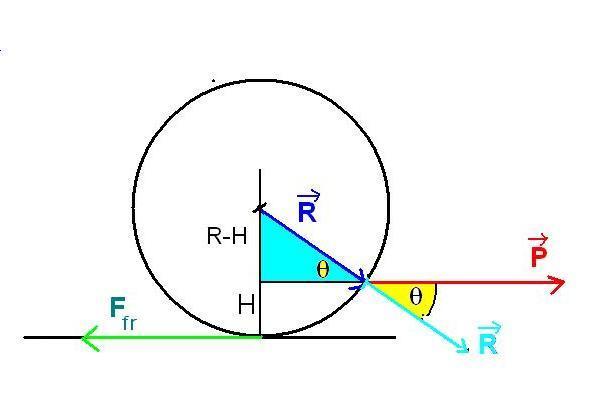

The angle between two vectors is the angle enclosed by the direction of the vectors. See picture. You need the angle between the position vector R and the force vector P. Shift the position vector R, so as its tail is at the same point as the tail of P. θ is the angle shown. In the blue right triangle, you can see that sinθ = (R-H)/R.
The torque of the applied force should be equal in magnitude and of opposite direction as the torque of the friction.
ehild

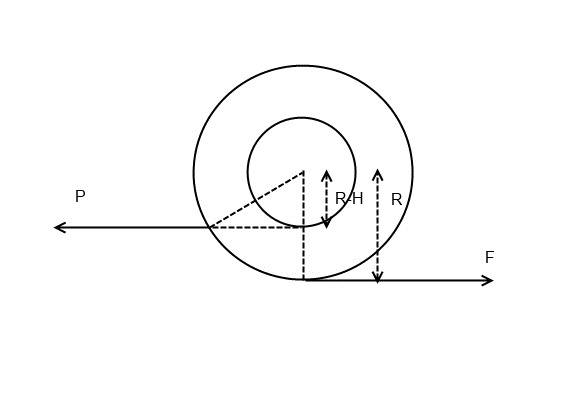

Remembering that torque is just force * tangential distance, if you pick the centre of the sphere to sum them around you can read off the distances from the drawing.
The tangential distance for the friction force is just R
The tangential distance for force P is ?
EDIT: I modified my drawing slightly...
