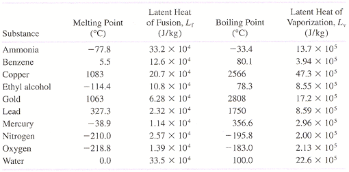

I'm still not getting the answer correct, I've now got:
(0.185)(9e2)(155) - (1.5)(4186)(-2.1) - (1.5 - x)(33.5e4) = 0
x = 1.3836 kg
I'm wondering if my quantity (1.5 - x) is wrong for finding the amount of ice formed?
Thanks for your help
EDIT: I'm getting my values for L from: http://www.webassign.net/CJ/12-03tab.gif if it matters.
You don't need to add the negative sign for the second term; it was already negative. (You've now made the second term positive!)
The mcΔT terms automatically have the right sign; but when you have an mL term you have to decide if the substance is melting or freezing, and then give it the appropriate sign.
Do you get the right answer?
