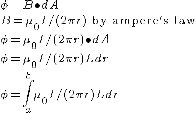

The rectangular loop shown has resistance 20.0 mΩ.
Determine the induced current in the loop at the instant shown.
Answer: 66.7µA
http://img264.imageshack.us/img264/7386/picture1nlz.png
induced emf = |d(flux)/dt|
I = emf / R

Well... the problem is that.. I got this far:
emf = | d(flux)/dt |
= dB * A / dt
= dB (0.04*0.01) / dt
= dB (4*10^-4) / dt
but i do not know how to get dB...;
in other words, i am totally lost.I have B(r) = u0I/(2*pi*r)

The loop is moving with respect to the wire. So the B(t) through the loop will be changing, since the B is weaker the farther you get away from the wire. Write an equation based on the Biot-Savart Law for the flux through the loop as a function of radius, and work from there...
Which radius should I use? The distance from the wire to the the inner side of the loop or the outer side of the loop?
You need to integrate over the loop radius.
I know this is old but I'm working on the exact same question.
So far i have this:
[PLAIN]http://www.texify.com/img/%5CLARGE%5C%21%5Cphi%20%3D%20B%20%5Cbullet%20dA%20%5C%5CB%20%3D%20%5Cmu_0%20I/%20%282%20%5Cpi%20r%29%20%5Ctextrm%7B%20by%20ampere%27s%20law%7D%20%5C%5C%5Cphi%20%3D%20%5Cmu_0%20I/%20%282%20%5Cpi%20r%29%5Cbullet%20dA%20%5C%5C%5Cphi%20%3D%20%5Cmu_0%20I/%20%282%20%5Cpi%20r%29%20L%20dr%20%5C%5C%5Cphi%20%3D%20%5Cint_a%5Eb%20%5Cmu_0%20I/%20%282%20%5Cpi%20r%29%20L%20dr%20%5C%5C%5Cphi%20%3D%20%5Cfrac%7B%20%5Cmu_0%20I%20%5Cln%7B3/2%7D%7D%7B%5Cpi%7D.gif
Where the bounds of integration are b = 0.02 and a = 0.03 and L= 4.0cm from the picture. This is where i get lost. I wanted to use faraday's law to use:
[PLAIN]http://www.texify.com/img/%5CLARGE%5C%21%5Ceps%20%3D%20%5Cmid%20%5Cfrac%7Bd%20%5Cphi%7D%7Bdt%7D%20%5Cmid.gif
Am i just totally going about this the wrong way by trying to use flux, and i have to use biot savart law?
