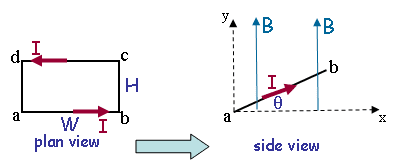

A rectangular loop of wire with sides H = 22 cm and W = 77 cm is located in a region containing a constant magnetic field B = 0.82 T that is aligned with the positive y-axis as shown. The loop carries current I = 334 mA. The plane of the loop is inclined at an angle θ = 30° with respect to the x-axis.
What is μx, the x-component of the magnetic moment vector of the loop?
μ = AI
A = H*W
I attempted to solve the question by solving for μ like μx = H*W*cos(30°) however this is not the correct answer. Thanks in advance!
Be sure you draw the magnetic moment vector on your diagram and carefully note the angle that the vector makes to the x-axis or the y-axis.
I'm a little confused on how to find the angle that the vector maxis to the x-axis.
What is the rule for determining the direction of the magnetic moment vector?
