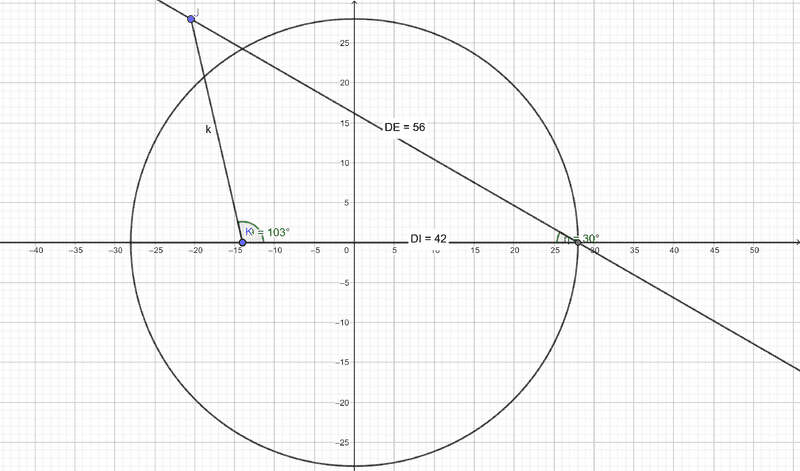

mcastillo356 said:
TL;DR Summary: It computes the supplementary
Exercise statement :
From a lighthouse you can see two boats. Ship ##M## is forty-two kilometers out to sea, and ship ##N## is at an unknown distance. If the distance between the ships is fifty-six kilometers and the angle formed in ##M## is thirty grades, how many kilometers are there from the lighthouse to ##N##, and which is the angle formed in the position of the headlamp?
1) $$b^2=a^2+c^2-2ac\cos{(\theta)}=826.336\Rightarrow{b=\sqrt{826.336}}=28.746$$
2) $$\cfrac{28.74}{\sin{(30^o)}}=\cfrac{56}{\sin{(x)}}\Rightarrow{x=77}$$
As shown at the Geogebra file, the angle is ##103^o##
Also, where is the guiding light at the sketch drawn?

Your drawing is not to scale. The side you labeled as 42 in your triangle appears to be a lot longer than the side labeled 56! Obviously it's important to work with drawings as realistic as possible. Here's a more realistic drawing based on the problem in the OP.
Note that this triangle, with its given data of an angle and two sides that don't include the angle, satisfies the conditions listed in the Wikipedia article I cited. We are very much in the situation of ambiguous triangles. Your major complaint about finding a solution that is a triangle that does not include the given angle (##30^\circ## in this case) is valid but doesn't take into account the ambiguity involved here. If the given angle had been angle LNM rather than angle LMN, that angle would have been part of both triangles.
In my drawing, L and L' are the two possible locations of the lighthouse. I used the Law of Cosines to find LN, the distance from the lighthouse to ship N, with ##LN \approx 28.74## km.
I then used the Law of Sines to find ##\theta## (angle LNM), with ##\theta \approx 46.94^\circ##.
Finding the third angle is tricky, as we're dealing with ambiguous triangles. Let ##\alpha## = angle MLN (the obtuse angle), and let ##\alpha'## = angle ML'L (the acute angle). Per the same wikipedia article, ##\alpha' = \sin^{-1}\left(\frac{56\sin(\theta)}{42} \right)## and ##\alpha = 180 - \alpha'##.
My results for these are ##\alpha' \approx 76.95^\circ## and ##\alpha \approx 103.05^\circ##.

Your 2nd equation above has an error: it says that ##\sin \beta \dots \approx 45^\circ##. This equation confuses the sine of an angle with the angle itself.
The Law of Sines does not give you the angles -- it is defined in terms of the lengths of two sides and the sines of two angles. It therefore gives you the sines of the angles, an important distinction. It is then up to you to determine what the angle is, keeping in mind that the sine function is not one-to-one. This means that both ##\beta## and ##180 -\beta## have the same sine value.
From post #66:
erobz said:
Using the Law of Cosines (as I have clearly demonstrated), it is not important to work with realistic drawings of triangles.
In your drawing in post #66, did you use the Law of Cosines to find the angle opposite the 56 side (shown as ##76.9699^\circ##)? If so, that is not the correct angle for the problem.
Having a realistic drawing would have led you to the correct value for that angle, which is about ##103^\circ##, which is the supplement of the angle you found. It can't be emphasized enough that in so many areas of mathematics, making a realistic drawing is a crucial step in the solution process.
