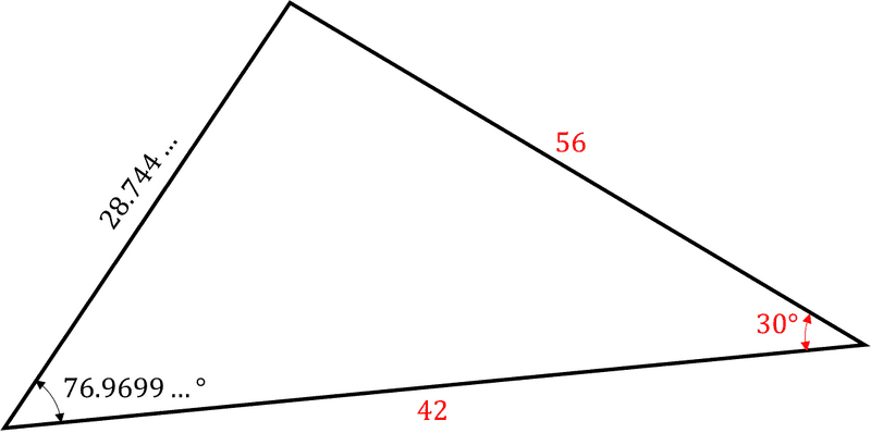

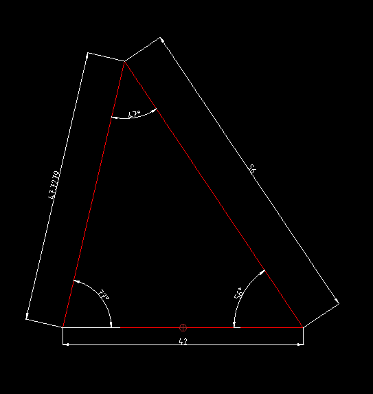

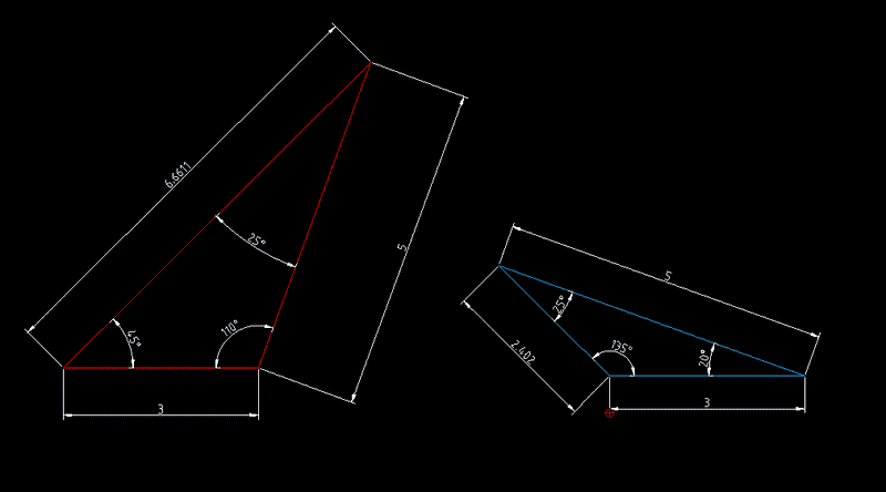

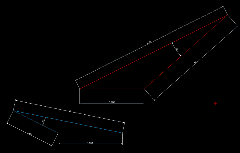

Yeah, there is ambiguity. But I have never had the math alter a fixed parameter before, to give me an unrelated solution of its choosing. It's clearly lesser in the hierarchy than the "Law of Cosines". There is no good reason to use a law that can unpredictably lie to you. If this were but a step in a larger problem and you accept it (it was a perfectly fine triangle after all), it could be a huge waste of time.Mark44 said:The fact that there can be answers that aren't applicable to a specific problem is less about the Law of Sines and more about the fact that the sine of an angle is equal to the sine of the angle's supplement.

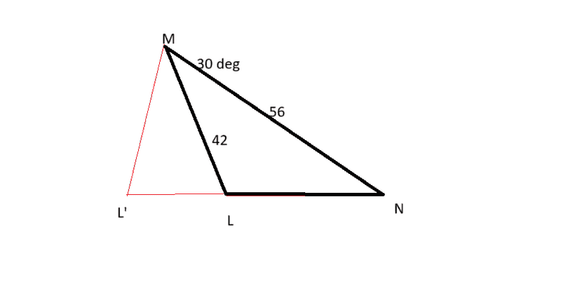

If you're given an angle and the two sides adjacent to it, you can always use the Law of Cosines to find the other angles and sides of a triangle. However, if you are given an angle and two sides, with one of the sides adjacent to the angle and the other opposite the angle, there are two possible triangles that can be formed.

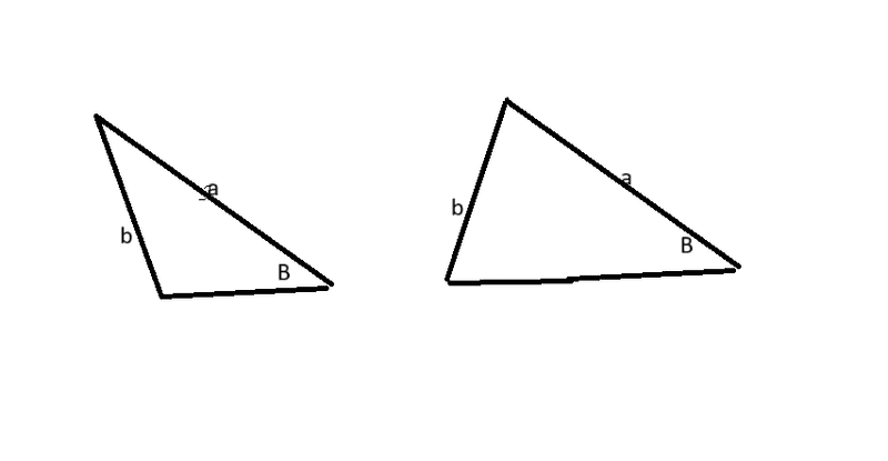

In the drawing below you're given angle B and sides a and b of the two triangles. If you use the Law of Sines to find angle A, you will need to choose whether the acute angle (as in the triangle on the right) or the obtuse angle (as in the triangle on the left) is the appropriate solution. This is why having a drawing with the sides and angles labeled is important.
