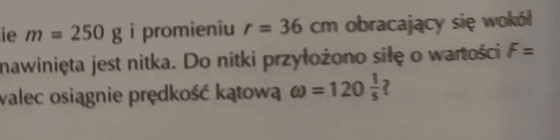

vhmth said:
how to practically think about the “radians” part of angular velocity
It is there, because people wanted to have unit for angle even though it is dimensionless so has no unit. I would say it is somehow psychological thing. But you don't have to use it! I've seen problem-books where authors do not use radians. I use them (rads) because "that's how I've been raised" o0)
Here's an example from a polish book that not everyone uses radians:
Not psychological; practical. Take a big formula out of a book with lots of ω's and θ's and re-write it in terms of degrees and frequency. But I can appreciate that it may be a bit intimidating and a bit showyoffy but Physicists have egos like the rest of us.
