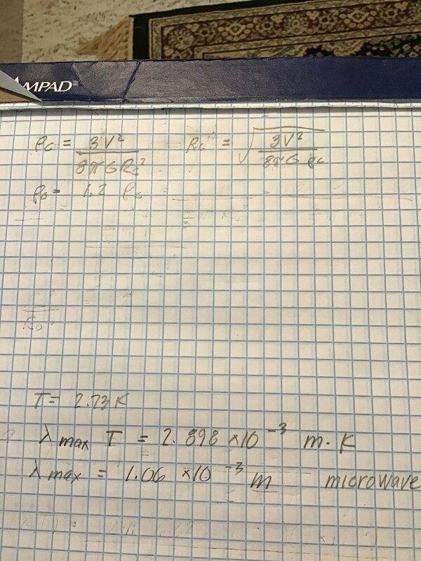

The average density of the universe is 1.2 pc. How many times larger will the universe become before it begins to collapse? That is, by what factor will the distance between remote galaxies increase in the future?
See below
According to our current cosmological model, the Lambda-CDM model which fits the data quite well, the universe will never "begin to collapse" It will continue expanding forever.

Rc = critical radius where kinetic energy of escaping galaxy = 0. Can be calculated from critical density formula given above.
Ro = radius where density = 1.2. I think what I am looking for is Rc/Ro.
The answer in the book is 6.00.

In my textbook, a large section of the universe is modeled as a sphere. The critical density is derived from the Hubble parameter H and the universal gravitational constant G. See formula above. The derivation considers a galaxy of mass m moving away from the center of the sphere. The kinetic energy of the galaxy is then equated to the potential gravitational energy.
