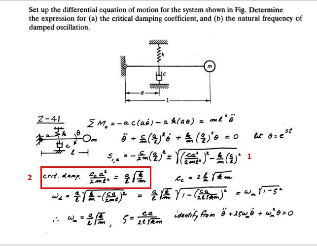

Hi, I was reading mechanical vibration, free vibrations.
and I don't know how to obtain critical damping.
there is a formula in the attached file, but I don't understand it :(
I would appreciate it if you tell me how did we obtain this formula .
