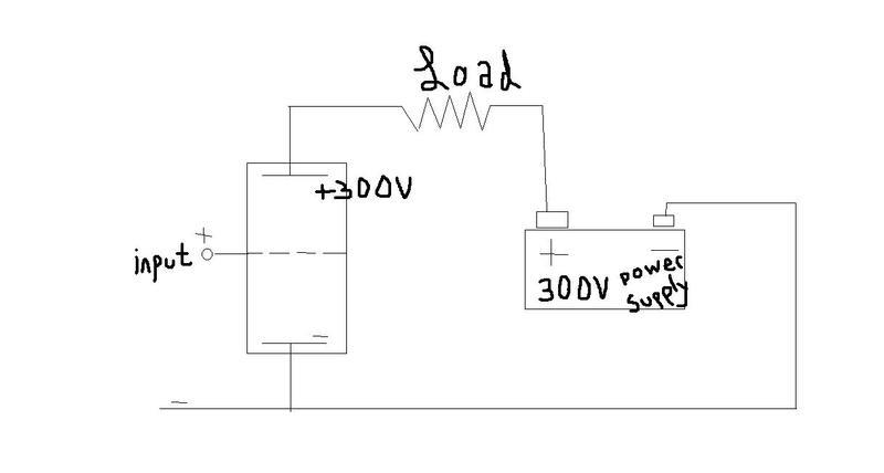

Here is my single triode vacuum tube amplifier circuit

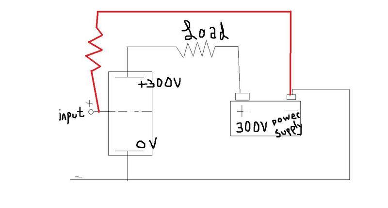

I understand there needs to be a bias on the grid otherwise the signal will be rectified -not amplified. Is biasing the grid as simple as running a resistor in-between the grid and the cathode on the power supply like this (in red)?
From my understanding, the ideal bias voltage on the grid would be -150V. This would allow the waveform to equally fluctuate from 0V to 300V within your rail voltage.
So?
So the cathode from the supplied voltage is 0V. How is wiring a resistor in series from the grid to the cathode giving you -150V on the grid? There is something about relative potential that I am not seeing.

Valve radios have two independent power supplies: low voltage AC to heat the cathodes (e.g., 6.3 VAC), and a smooth high voltage DC known as B+ (e.g., 300 VDC) supplying the plates (anodes). There is no negative supply.
Your bias resistor should be in the cathode circuit and bypassed for ac with a capacitor (for class A linear operation). Do an image search for common cathode triode amplifier.
With a 300V supply voltage, aiming for a 300V peak-to-peak output isn't realistic. 200V would be a a lot. The other factor you forgot is that the tube is a voltage amplifier. So for a voltage gain of say 20, a 200Vpp output would only need about 10Vpp on the grid.
As TurtleMeister said, you would put a "small" resistor between the power supply ground and the cathode, to raise the cathode voltage to about 10V above ground, and the grid voltage would then swing a few volts either side of -10V relative to the cathode.
Grid leakage is sometimes used to provide bias when cathode is grounded and there's no negative supply.

As TurtleMeister said, you would put a "small" resistor between the power supply ground and the cathode...
Got it!
Put a small resistor in-between the PSU's GND and the cathode and the valve should idle (forgot about this term) somewhere in-between 0 and 300V.
