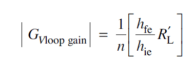

suv79
65
estimate the value of turn-ratio n
[/B]
R1=4.7 kΩ, R2=24 kΩ, Rl=2.7 kΩ, hfe=250, hoe=10^-5, hie=4 kΩ
loop gain=1/n[hfe/hie*R'l]

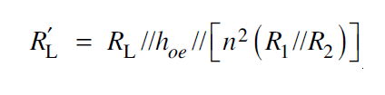

R'l=Rl||hoe||[n^2(R1||R2)]

loop gain=1
[/B]

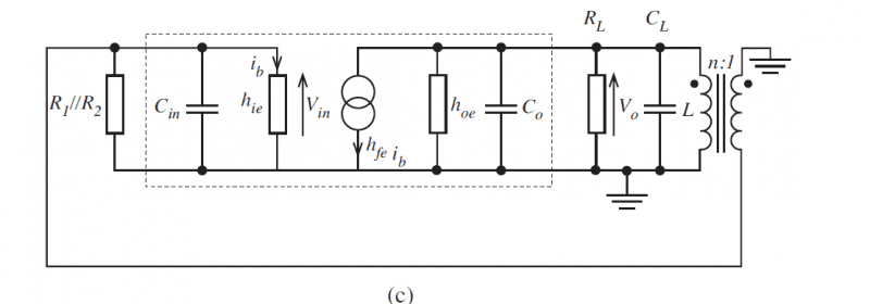

1. Open the feedback loop and calculate the complex voltage gain (amplitude and phase. In doing so, the transformer secondary must be loaded wit the same complex impedance that the closed loop sees.) Assume k=1 for the transformer.
2. Invoke the Barkhausen criterion or whatever it's called these days: O/L gain = 1.0,
phase = 0.

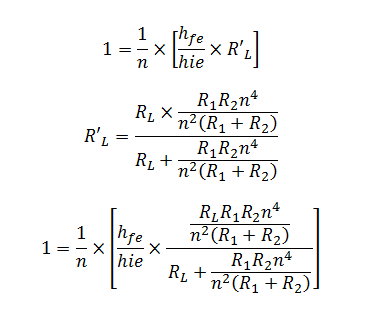

iam having a problem with my maths, to work out 'n'
in my attempt i have got stuck
suv79 said:
yes loop gain is 1 to make it oscillate, and the feedback is positive, so there is no phase shift. :)
so let's see your math
ok :) so i can ignore the siemens Hoe, reciprocal which is very large,
i was thinking it was quadrature, :) but was not sure
Right, hoe can be ignored.

cancel out top and bottom ?
You could cross-multiply in the denominator, then cance l out n2(R1 + R2). Tha's assuming your equation is right to begin with.

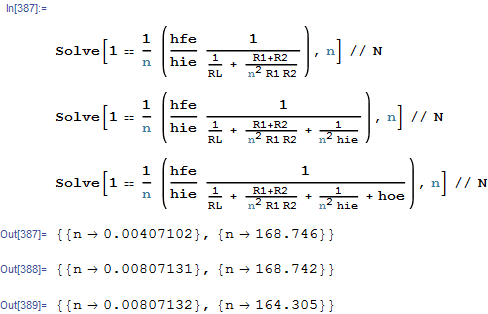

Looking at your 1st eq'n in post 9, this is a lot like what I have:
change your R'L into a conductance 1/R'L:
so 1/R'L = 1/RL + 1/ n2R
where I define R = R1||R2.
Now, what I notice is you didn't include hie as a load on the transformer secondary. So the above changes to
1/R'L = 1/RL + 1/ n2R + 1/n2hie
And your 1st equation in post 9, being
(ignore 2nd & 3rd equations)
makes your equation 1 = (1/n)(hfe/hie)/(1/R'L) with the new 1/R'L
which wouild then agree with what I came up with.
So, bottom line, include conductance 1/n2hie and write the equation in conductances rather than admittances, and you have a cubic expression for n that goes as an3 + bn2 + c = 0.
EDIT: I looked up the solution for this equation with b = -1 and it is horrendous. You would definitely need some kind of math software to solve for n. I would leave the equation as is and hand it in with the answer being "the real solution of an3 - n2 + c = 0." :) (Defining a and c of course in given parameters).
(The other two solutions are imaginary).

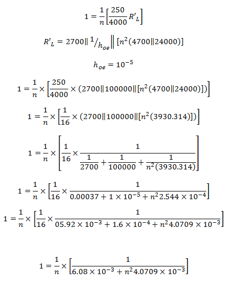

i don't think i need 1/n2hie
because equations given in the question don't not have it in for R'L
hie is in parallel with R1||R2. You included R1||R2; why not also hie? And hie and R1||R2 are almost equal so you can't say hie >> R1||R2.
R'L is effective resistive load, R1||R2 feeds the transformer
hie is the input impedance
You can make a tentative assumption that n >> 1 and solve for n. This makes the math trivially simple. Then, if it turns out that n >> 1 you were justified in the assumption.

It looks to me like neglecting hoe makes a much larger difference than neglecting the loading effect of hie

Your values for n correspond very well with mine ( n = 164 to 169 range; I came up with n = 169. As I said, you can make life much simpler if you assume n >> 1, then all you're left with is R'L = RL.
