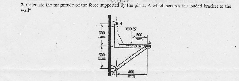

I've seen someone's solution in which they did the following:
$$600(200)-R_{AH} (600) = 0$$
How did they arrive at that conclusion by taking the moment about $A$?
  • Engineering statics diagram of a bent bracket attached to a vertical wall at pins A and C, with a 600 N downward load, dimensions 300 mm, 300 mm, 200 mm and 400 mm, and a diagonal member meeting the bracket at point B.

Hey Rido! (Wave)
The third equilibrium condition is that the sum of the torques must be zero.
The torque of the vertical 600 N force with respect to A is
$$+600\text{ N} \cdot \frac{400\text{ mm}}{2} = +600\text{ N} \cdot 200\text{ mm}\tag 1$$
Apparently clockwise has been chosen to be positive, so this torque is positive.
In A and C there will be vertical force components and horizontal force components.
The vertical force components have a lever-arm of zero with respect to A, so the corresponding torques are zero.
The horizontal force component at A also has a lever-arm of zero.
So that leaves only the horizontal force component at C.
Let's use the symbol $H_C$ for the horizontal force component at C, which is pointing to the right.
Then the corresponding torque is:
$$-H_C \cdot (300 \text{ mm} + 300 \text{ mm}) = -H_C \cdot 600\text{ mm} \tag 2$$
This is negative, since it would make the structure turn counter clockwise.
So the total sum of torques is (1) and (2) together:
$${}_+^\curvearrowright\sum T_A = +600\text{ N} \cdot 200\text{ mm} - H_C \cdot 600\text{ mm}$$
Btw, I don't know why the symbol $R_{AH}$ was chosen for $H_C$.

The reason why I posted it was because the above link confused me. (See #2). I guess they used the wrong letter? (Presumably my 80yo+ prof)
Rido12 said:
Thanks ILS! (Wave)
http://skule.ca/courses/exams/custom/20099/CIV102_2009__1329360871.pdf
From your notes I can see that $R_{AH}$ is the force at $A$ that is $H$orizontal.
I'm guessing that he picked the letter $R$ for $R$eactive force.
Either way, it means the torque was calculated with respect to $C$ and not with respect to $A$. :eek:
Moreover, the direction of $R_{AH}$ has been picked to point to the left.
