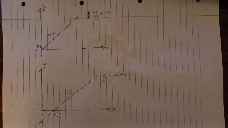

It's a rightward moving wave for ##v > 0##. At ##t =0##, the wave takes the form of ##y = f(x)##. Choose a function ##f##. Something simple. For example ##f(x) = x##. Draw that initial state of the wave on a graph.
Then, for ##t = 1##, say, the wave takes the form ##y = f(x -v) = x -v##. Draw that state of the wave on a graph. Take ##v = 1## as well, so that ##y = x - 1##.
Has the wave moved left or right?

That's not two graphs! This is what the graphs of ##y = x## and ##y = x-1## look like.
PS I've shown two points on the wave (P and Q) at times 0 and 1.

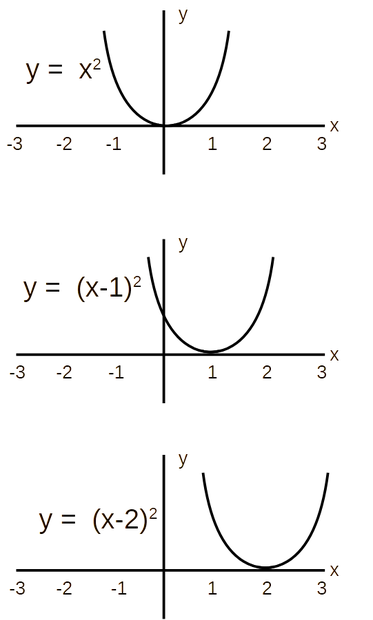

Another example: consider the function ##f(x)=x^2##, whose graph is a parabola opening upwards, with its vertex at ##(x,y)=(0,0)##.
For ##v=+1##, ##f(x-vt)=(x-t)^2##.
At ##t=0## we have the original function.
At ##t=1##, ##f(x-vt)=(x-1)^2##. It's still a parabola. Where is the vertex?
At ##t=2##, ##f(x-vt)=(x-2)^2##. It's still a parabola. Where is the vertex?
