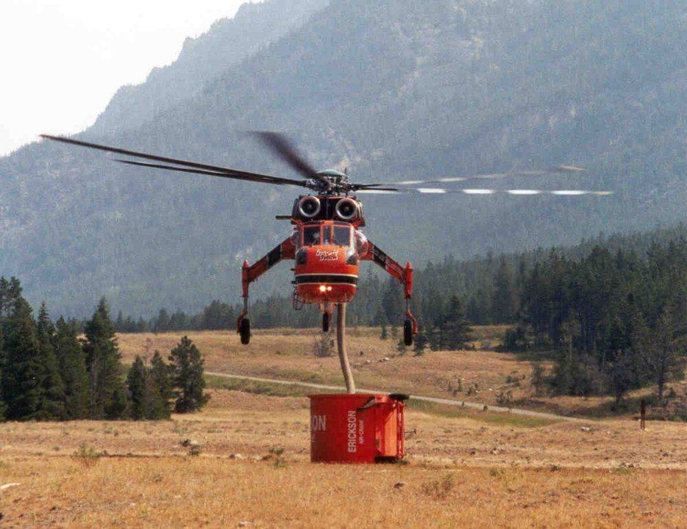

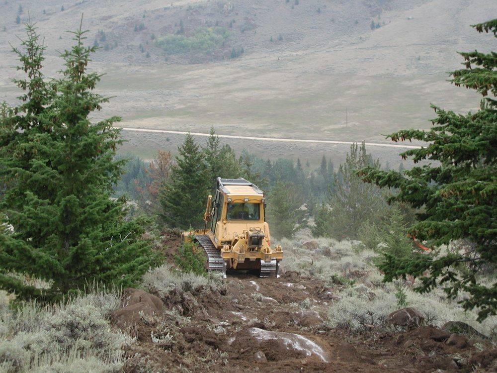

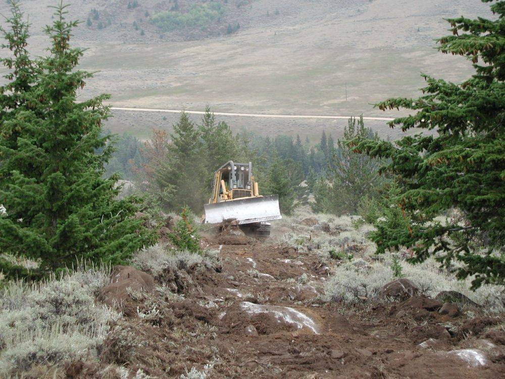

. . .there are probably other better approaches to fighting the active wildfires. . .

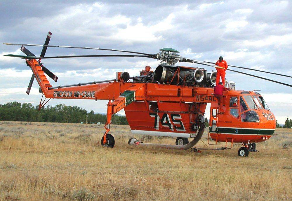

Copy that. . . . 🙂Yes, there are. . .
Willie Fire-Red Lodge, Montana
berkeman said:
Your heart is in the right place, IMO.
Yes. . . it's just that the logistics would be so very, very, difficult.
Most Wildland Fires here in Montana are in terrain similar to the above pictures.
Lol. . . yeah, that is me in the dozer. . :oldbiggrin:

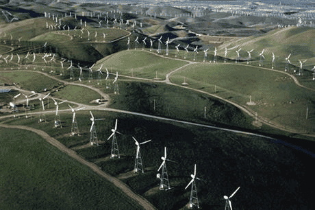

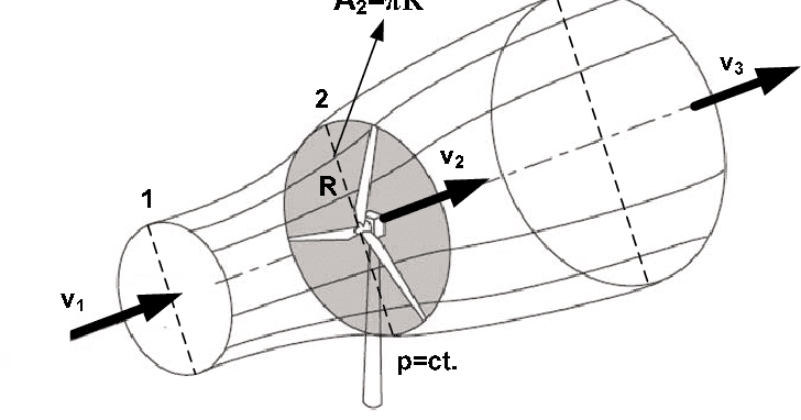

Count me as skeptical about this idea.

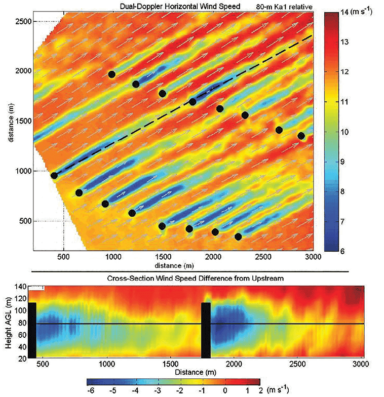

@Z0dCHiY8 , do a simple experiment. Go to one of those wind farms. Carry a hand-held wind meter. See how much difference in wind speed you will find upwind compared to downwind. I'll wager the difference will be too little to measure.

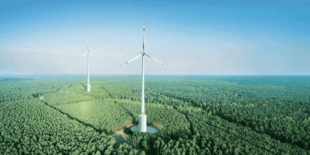

Other points:
  • In a forest with 100 foot trees, the wind turbine towers would need to be 100 feet taller than otherwise. That's a lot of cost.
  • Wind farm owners typically have to buy the land or buy an easement for their locations. They would love the idea of free public land. Land preservation advocates would really hate the idea of giving away public land for private profit.
  • If a tank of retardant at the top of the tower could be effective and affordable, I think they would already do that to protect their own self interest.
  • The ability to make extra electricity for 1 hour out of the life of the turbine is equivalent to your mortgage holder saying that they will give you one hour reduced interest over the life of the loan.
at Forest fires, we deal w/ bunch of local winds. They ain't stable by their power & direction. The very goal is to pound the "bad" directions, so it makes fire expansion more slow.
here is curious moment == we have to deal w/ ground winds at range (0-5 meters from the ground). Ground winds have provide the Lion's share of Wildfire speed. at high altitudes, ash/embers lose the most of its temp & have lowest probability to spark new fires.
I honestly couldn't tell you what the wake does at ground level. 100m up though, turbines severely reduce windspeed for distances up to a kilometer or two behind the turbine. This is especially true if the wind speed is around 11-12m/s or lower, where the turbine is operating near its maximum thrust coefficient.
anorlunda said:
Other points:
An extra 30m of tower height honestly isn't as much of a deal as you're thinking here. Sure, it adds, cost, but it's absolutely something that is done sometimes. It all depends on the local mean windspeed, the costs, the goals for the power generation, etc. It can even be a good thing in areas with strict noise regulations - the extra tower height plus the trees can help significantly reduce the noise level produced by the turbine compared to a similar one mounted 30 or 40 meters lower in an empty plain.
Also, in general, I think you're underestimating just how large these are. Especially in a forest with shorter trees (say, 10 or 20 meters), the turbine's overall height is barely even affected. Modern turbines use towers in the 60-70 meter range at the lowest, and at the high end, towers as high as 140-180m or so have been done. The trees just really don't provide much impediment when the turbines are that tall.
I think you mean they disturb the wind turbulent downwind, not reduce the speed. Disturb means that turbulence makes it move in swirls and eddies.
Simple conservation of mass says that mass flow upwind of the turbine equals mass flow downwind of the turbine. Some of the wind might be deflected sideways. But the air just downwind must move out of the way to allow more air to come in from the upwind side.
No, the windspeed is reduced. Conservation of energy requires this, actually, since all the power generated is coming out of the kinetic energy of the wind. Now, what this means from a conservation of mass/continuity standpoint is that the effective region of air affected by the turbine is smaller in diameter than the rotor itself upstream of the turbine, and larger than the rotor downstream of the turbine. As this flows through the turbine, it slows down, but the cross sectional area of the streamtube grows, satisfying continuity but also slowing down. Flow that passes adjacent to the turbine is also deflected away, due to this growth in the diameter of the wake downstream of the turbine (and of course there's also lots of fascinating turbulence and mixing that goes on). In case this explanation isn't very clear, here's a diagram:
At lower wind speeds up to 10 or 11 m/s, as I said, most modern turbines are running an induction of around 0.25-0.3, so the wind speed in the wake might be as low as half (or even a bit below) the freestream value. You can see this very clearly in doppler-measured wind speeds within a wind farm, as seen below:
Thanks. I stand corrected.
To be fair, fluid flows in general (and wind turbines in particular) aren't the most intuitive things in the world. I do find them fascinating though.
