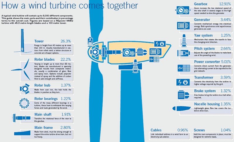

Good stuff, thank you. Looking at the graphic below for a 5MW wind-turbine, there is a great deal of cost getting from the turbine to the generator. And, according to this article, the transformer should not be something off-the-shelf but constructed to deal with the variable velocities of the generator.
I propose that using hydraulics as the interim transmission and driving a standard generator at a constant RPM would have similar, if not better efficiency, and reduce much of the upfront cost. 120:1 gearbox alone is between 80-90% efficient.
18-20% of a 5-6 million dollar system is a lot of room to work with.
And there are other things that can be done easily such as regenerative dynamic braking to limit high speeds rather than simply stopping the whole system. That alone could increase overall output in areas that have a lot of extreme wind conditions that require the turbine to be shut down.
It is definitely worth exploring.
True, the converter is a large chunk of the cost, which is part of the reason for the use (in some cases) of the doubly-fed induction generator I mentioned above. They reduce the cost of the converter considerably, at the expense of a small amount of efficiency and a reduction in flexibility when it comes to reactive power and grid support.
120:1 gearbox alone is between 95 and 97% efficient. There are nowhere near the magnitude of losses you're supposing here. Overall system efficiency is between 85 and 90%, from input shaft power to electrical output.
You're high by about a factor 2 on the cost of a modern 2-3 megawatt machine.
