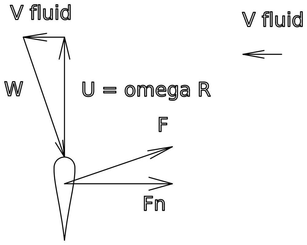

These wind turbines use the principle of aircraft wings. The force induced on the profiles of the blades is due to the relative speed created by the rotation speed and the speed of the fluid.
The induced force can be broken down into two forces, one force combined with the radius that creates engine torque and another much larger force that creates bending stresses on the blades.
In fact, the turbine 'converts', if you will, this axial force in a torque, so the bending stress is directly related to the torque and rpm of the blade.

"In fact, the turbine 'converts', if you will, this axial force in a torque, so the bending stress is directly related to the torque and rpm of the blade."
For a horizontal axis turbine, the bending stress is constant over time if the fluid velocity is constant. This is not the case for a Darrieus turbine.

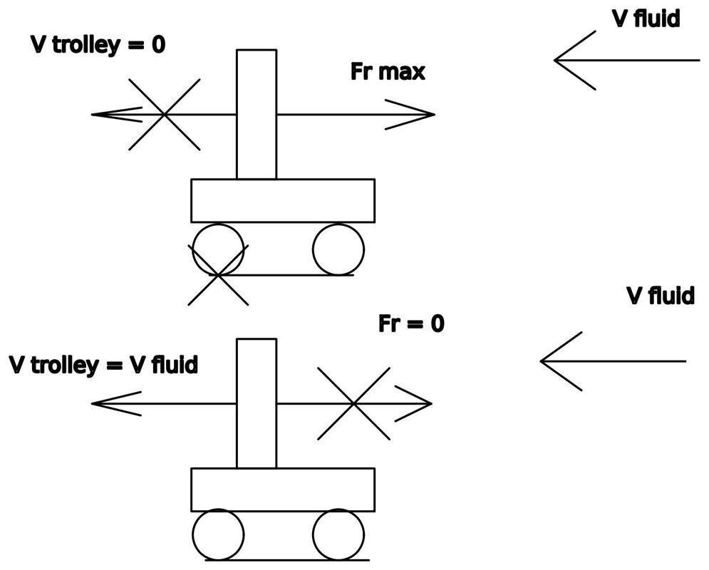

If we consider a trolley with a vertical plate exposed to the wind. If the trolley is free and without any resistance, it will move at wind speed and the vertical plate is not stressed.
If the wheels of the trolley are welded, the trolley speed is zero and the vertical plate is under maximum stress.
In the case of a wing profile, we add a displacement speed U which changes everything.
Normal force to the profil of the blade creates stresses in the arms of a Darrieus type turbine.
When calculating a mast for a wind turbine, we consider the force defined by Betz associated with the swept area.
In theory, the Betz force associated with the swept area is used entirely to produce energy, and is used entirely to calculate the stresses.

I've completely and utterly lost you. Don't have a clue what you mean.

For a Darrieus-type turbine, I transform potential energy into kinetic energy, by replacing the arms with crank and connecting rod systems. This allows me to obtain a much higher efficiency than the one defined by Betz.
Ok, what I think you mean here is that the stresses in the arms are alternating between compressing and stretching forces. This could be used to drive some kind of converter producing energy. This however will not generate any extra energy. Since the energy that is used to drive this converter cannot also be used to generate a torque on the turbine and vice versa (is this why you think there is a factor 2 increase in efficiency?). This means that now you've just got two parallel conversions, each converting a part of the incoming kinetic energy.
But it doesn't matter how you convert the kinetic energy to whatever other kind of energy, or combination of other types of energy, or combination of converters, or combination of types of energy and converters or whatever... This input amount of kinetic energy is your only input of energy to the system.
