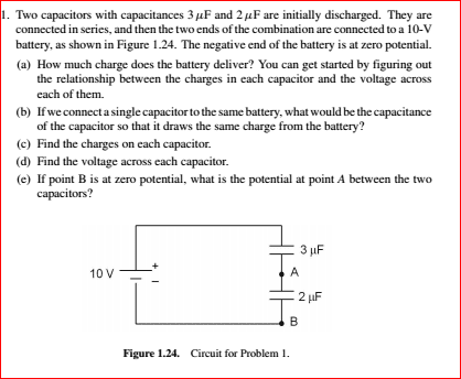

The discussion revolves around calculating the charge delivered by a battery in a circuit involving capacitors in series. Participants are exploring the concept of equivalent capacitance and its application in determining charge using the formula Q=CV.
- Exploratory, Conceptual clarification, Mathematical reasoning, Assumption checking
- Participants discuss the method for calculating equivalent capacitance for capacitors in series and question the correct application of the formula. There are attempts to clarify misunderstandings regarding the reciprocal relationship in series capacitance and the implications for charge calculations.
There is ongoing clarification regarding the calculation of equivalent capacitance, with some participants providing corrections and guidance. Multiple interpretations of the problem are being explored, particularly around the physical understanding of voltage and charge in capacitors.
Participants note previous mistakes in similar problems, indicating a potential pattern in misunderstandings. There is a discussion about the terminology used in describing charge on capacitors, suggesting a need for clearer conceptual understanding.
