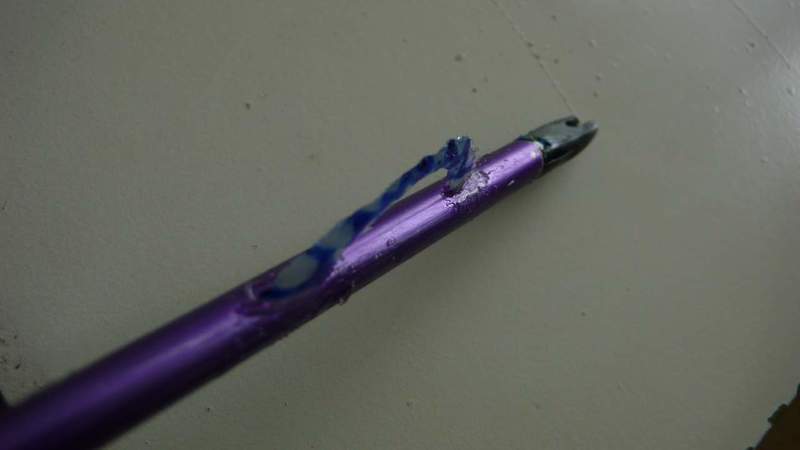

- Arrow with no stabilization flies furthest (70 steps), but it flies weirdly and lands somewhere in general direction of the shot.
- My spinning arrow flies almost as far as arrow with no stabilization (66 steps), it's trajectory is very predictable.
- Regular arrow flies shorter distance than my arrow(55 steps), it's trajectory is quite predictable, but it fishtails a lot.
- Spinning arrow with screwed fletches flies shortest distance (50 steps), it's trajectory is very predictible.

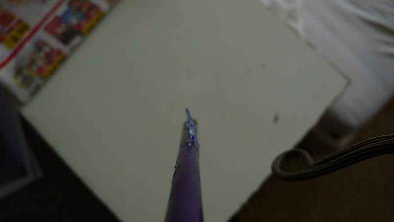

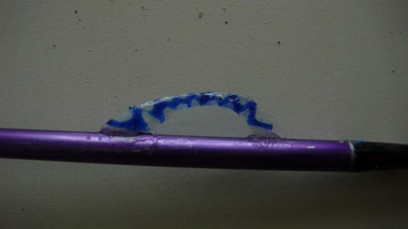

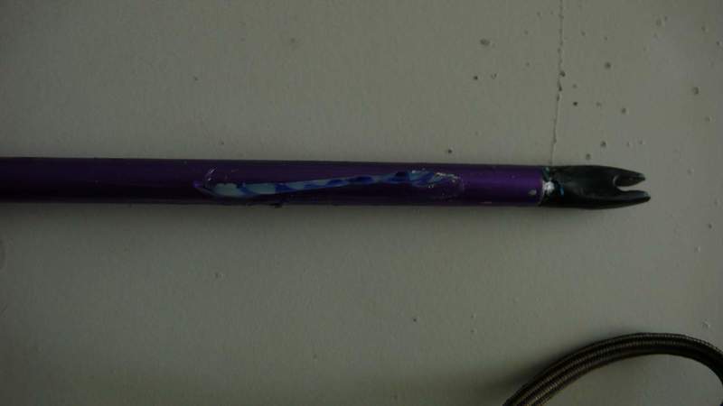

I made some pictures of my recent arrow. The surface area of fins is about 7 times smaller than that of original arrow. My blade is much smaller, it has opening in it and there is just one instead of 3. Frontal area is hard to tell, but it is also smaller than area of 3 blades at original arrow.
I am trying to make the turbine as small as possible and see if it is still sufficient for rotating. Right now I am limited by my skills. The (master) turbines are hand made, the 3D printers I know about are all useless for something so small.
My arrow is more aerodynamic and create less drag than fins, that is the whole point. It uses air flowing around the turbine blade to create lift instead of letting the air hit the turbine to create drag. The blade actually avoids the incomming air. That is why it is twisted. It may look almost the same as drag turbine, but it is a totally different principle, much more efficient one.

Arrow principle
This post may seem strange at first. Let me start it off with some results:
My arrow now flies more than twice as far as original arrow with fletches. It also flies significantly further than arrow with no stabilization, which should be the most aerodynamic one of them all.
This seem to defy laws of physics. It doesn't. Let me explain.
My arrow is quite complex machine. It doesn't look it, but it has many function built into its design. The most important functionalities of my arrow are:
- it is a stabilizer
- it is a turbine
- it is a propeller.
Most importantly, it is all of the above at the same time.
When I shoot my arrow, it consumes part of its energy and turns it into rotation (turbine). The rotation is used for stabilization (stabilizer). At the beginning the arrow flies very fast, so the turbine starts spinning very fast too. But the arrow slows down. When the forward speed diminishes enough, the spinning speed is too high and the turbine stars working as a propeller. It pushes air to the rear and speeds the arrow up. Rotation decreases, forward speed increases. That is going on until the forward speed surpasses the rotation speed. Then the arrow starts slowing down again. And so on and so forth.
So my arrow is actually a complex machine. It harvests kinetic energy and transfers it into a rotation. It uses rotation to stabilize itself and to store excess energy. When the arrow slows down it transfers the energy of rotation into increased speed.
Ordinary arrow doesn't recycle the excess energy for stabilization. It is gone forever. Unstabilized arrow may be more aerodynamic than mine, but the same thing applies. It doesn't transfer, store and reuse its energy.
