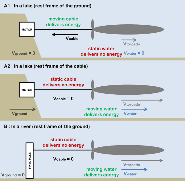

ryanabc67 said:
TL;DR Summary: Q: "does it take more energy to accelerate at higher speeds"
A: The 'usual answer': "Your kinetic energy grows exponentially"....yeah, but how much FUEL do you burn?
CHANGE IN KINETIC ENERGY DOES NOT EQUAL CHANGE IN REQUIRED ENERGY.
Yes it does. Remember that if you start running, the Earth changes speed too. Factor that energy change in too and you'll find your lost energy.
Consider two bodies, masses ##m## and ##M## that are initially at rest. They push off each other, acquiring velocities ##v## and ##V## respectively. Conservation of momentum tells you that ##v=-MV/m##. What was the energy change? Since the initial KE was zero, it's just ##\frac 12mv^2+\frac 12MV^2##.
Now analyse again, in a frame where the initial velocities were ##u##. The final velocities are ##V+u## and ##v+u##. What's the energy change? $$\begin{eqnarray*}
\Delta E&=&\frac 12m(v+u)^2+\frac 12M(V+u)^2-\frac 12mu^2-\frac 12Mu^2\\
&=&\frac 12mv^2+\frac 12MV^2+mvu+MVu\\
&=&\frac 12mv^2+\frac 12MV^2+m(-MV/m)u+MVu\\
\end{eqnarray*}$$This is the same as before. But you will not get the same answer if you disregard the energy given to one object - that is where you are going wrong, as noted by both posters above.

ryanabc67 said:
So, why is this wrong; what am I missing here...
Every time you accelerate, you must lose mass.
ryanabc67 said:
I'm sitting in space with my jetpack on. I weigh 2kg (not 1kg). I'm stationary and not moving.
Once you begin accelerating, you won't be 2 kg of mass anymore. You will have to push some part of you (the fuel in the jet pack) in the opposite direction, forever lost to you, now going at a certain speed away from you.
When you are on Earth, your mass is your combined masses, not just 2 kg of you. You can push yourself off the Earth. The Earth - or part of it - will be the mass acquiring momentum away from you.
ryanabc67 said:
I just don't understand why.
It is wrong because you neglected the conservation of momentum.
As others have said, energy is conserved and it is also frame variant. But conservation of energy is not the only important conservation law. You must also consider conservation of momentum.
When you accelerate in your jet pack you will release a tremendous amount of energy. In a frame where you have a low velocity the vast majority of that energy will go into the exhaust. In earths frame more goes into you and less into the exhaust. You cannot neglect conservation of momentum in any frame and get the right answer

russ_watters said:
Also, others pointed out the Newton's 3rd Law implications but my gut tells me(without calculating) the "missing energy" is negligible for a car that acts against the Earth.
This is incorrect. It depends on what reference frame one adopts.
If one adopts a reference frame in which the road is moving then an accelerating car is doing non-negligible work on the moving Earth.
If you add it up, any unexpectedly high gain in kinetic energy because the road is moving is exactly compensated for by a loss in kinetic energy of the moving Earth.

jbriggs444 said:
that is still where the discrepancy in an energy analysis can be found.
Sorry but numerical examples leave me confused. Symbolic algebra keeps the information healthy all the way. Numbers are anonymous and just one zero can be easily lost or found.
My point was that wherever the energy comes from, the amount needed will be the same. You don't need a reaction propulsion system to show how the KE gained is frame dependent. I could have used a two stage rocket system and the KE gained by the upper stage could be independent of the propellant system. A force applied applied over a given distance produce an increase in energy of ΔE = Fx. The rocket equation result is not relevant.
