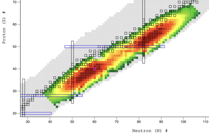

Taking a look at the Chart of Nuclides, and the independent fission yields (IFY) of 235U and 239Pu (for thermal neutrons) sit on or below the 'line/curve of stability', so they are inherently 'neutron-rich'. See attached image (green means very low probability, the orange/brown squares are below the 'line/curve of stability'.

Neutron-rich isotopes of fission fragments, however, DO form naturally on Earth as products of spontaneous fission.
Certainly.
For general interest - https://indico.fnal.gov/event/16420/attachments/23235/28811/NVassh_FRIBGW170817_2018.pdf

Incorrect. I was referring to radionuclides, as in "The further a radionuclide is from the 'line/curve of stability' the lower the fission yield." This is evident when reviewing the 'chart of nuclides'. Not only is the fission yield lower, but the half-lives tend to be shorter, i.e., the radionuclides are less stable.
For ease of doing the review, let´s see the chart as link again:
https://www.nndc.bnl.gov/nudat3/
Let´s compare nuclides and take Rb for example. Independent fission yields (IFY) of 235U, and half-lives and modes
  1. 84Rb - 2.16*10-12; 33 d; β- and 96.1% β+ and ε
  2. 85Rb - 2.37*10-5; stable
  3. 86Rb - 3.22*10-8; 19 d; β- and 0.0052% ε
  4. 87Rb - 2.50*10-5; 4.97*1010 yr; β-
  5. 88Rb - 2.23*10-4; 18 min; β-
  6. 89Rb- 2.04*10-3; 15 min; β-
  7. 90Rb- 7.06*10-3; 2.6 min; β-
  8. 91Rb- 2.22*10-2; 58 s; β-
  9. 92Rb- 3.13*10-2; 4.48 s; β- and 0.011% β-n
  10. 93Rb- 3.06*10-2; 5.85 s; β- and 1.46% β-n
  11. 94Rb- 1.56*10-2; 2.74 s; β- and 10.3% β-n
  12. 95Rb- 7.63*10-3; 0.38 s; β- and 8.75% β-n
  13. 96Rb- 1.68*10-3; 0.2 s; β- and 13.8% β-n
  14. 97Rb- 3.79*10-4; 0.17 s; β- and 25.5% β-n
  15. 98Rb- 2.35*10-5; 0.115 s; β- and 14.3% β-n
  16. 99Rb- 4.67*10-7; 0.054 s; β- and 19.8% β-n
  17. 100Rb- 3.47*10-4; 0.052 s; β- and 6% β-n
  18. 101Rb- 1.57*10-8; 0.032 s; β- and 27% β-n
  19. 102Rb- 1.47*10-11; 0.037 s; β- and 65% β-n
I guess it´s typical (maybe of odd elements?) but I haven´t taken the time yet to write through the other elements. Note key features:
  1. there is tendency for the stability of isotopes to fluctuate, Rb-86 has halflife 18 days but Rb-87 50 Gyr
  2. there is a small but nonzero yield of stable isotope - and indeed of radioactive, neutron-poor isotopes
  3. from the stable Rb-85 the stability decreases with increasing mass number, with fluctuations, but the yield increases, also with fluctuations, up to Rb-92 (halflife 4,5 s). Only after after Rb-93 do both yield and stability decrease as you say.
Astronuc said:
Please explain one's statement. Burnup, in the context of a nuclear reactor, is simply the energy produced per unit mass of fuel. One may quantify burnup in terms of fissions per initial metal atoms (FIMA, often given as a percent) or in terms of MWh/kgHM or GWd/tHM, where HM = heavy metal atoms, which is U in conventional LWR, or (Th, U, Pu)X, where X could be O2, N, C, Zr, Mo, . . . .
My next passage you quoted.
FIMA would be an indicator of the probability that a nucleus has captured not just one but multiple neutrons.
But in an ore, where FIMA is accumulated over a period much longer than the halflife of the daughter (Pu-239), it is not actually relevant. What matters is the amount of fissions that takes place before the daughter decays in her turn.
