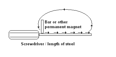

take a screwdriver or other piece of iron/steel and repeatedly stroke along the length of it with a permanent magnet. The more often done, the more the piece of metal will become magnetised

There is no way that you can do it electrically because you need a large steaming piece of kit to get a good result but, if you already have one of those 'super magnets' (available from many sources) you can easily magnetise a steel object with the 'stroking method' (look it up for how to do it). One good thing to do is to magnetise a steel rod / tool and hang it on a thread or float it on a saucer in water. It will make a pretty convincing compass. You need to keep stroking for quite a while but don't worry, you are unlikely to be de-magnetising your permanent magnet because the energy for magnetising the rod comes from you.
I've tried stroking method and stroked about 50-60 times (is it enough ) at piece of iron but It doesn't become magnetized ,,, why ??
Iron will not work. It had no remnance. Use STEEL like I said.

here's a pretty pic of how I usually magnetise a length of steel like a screwdrive blade...
NOTE the circular pattern I use
even as few as 10 passes will have the blade easily magnetised to pick up and hold screws etc
Dave
