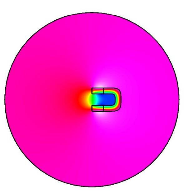

I see but those concepts are used in simulations when defining magnetization as a boundary condition or material property. For example, on the page 99 of this document: https://www.nic.funet.fi/index/elmer/doc/ElmerTutorials.pdf
It's defined this way:
Name = IronPlus
MgDyn2d
Relative Permeability = 5000.0
Magnetization 1 = Real 750.0e3
Name = IronMinus
MgDyn2d
Magnetization 1 = Real -750.0e3
where IronPlus is assigned to the upper pole of a horseshoe magnet while IronMinus is assigned to the lower pole.
Magnetic field intensity vector symbols in the results of this simulation go from the lower end to the upper end:
So the lower end should be a north pole while the upper one should be a south pole, right? Then the convention is that the north pole has negative magnetization while the south pole has positive magnetization? I just wonder if it's always the case.
That doesn’t make any sense to me. It seems like that software is trying to do some sort of a workaround. That isn’t how magnetization works in physics. Maybe that is the best approximation that software can do in some sense.
Edit: it looks like the software is trying to avoid any simulation inside the material of the magnet. Magnetization is only non-zero inside the magnet material itself. That appears to be blank in the software.
It may look like this based on the image I attached but they commented it:
Note that the fields in the horseshoe itself have been masked away to demonstrate the well known field shape in the free space.
And the previous image shows the vector potential of the magnetic field also inside the magnet:
Their approach to magnetization can be somewhat strange though. I haven't heard about it in the case of other simulation software. Magnetization values are normally not defined there for magnetostatic simulations. I guess I'll have to ask on their forum.
