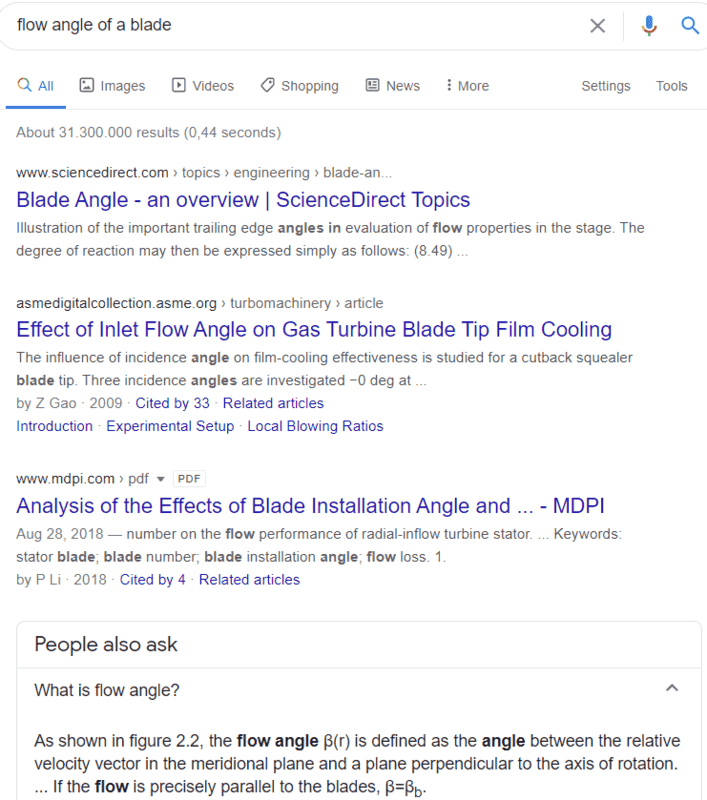

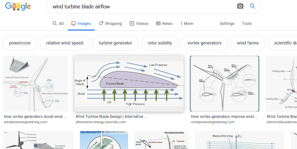

I did the following Google Images search, and got some helpful diagrams. Try a similar search to see what kinds of airflow diagrams you can find...
Oh sorry, I was thinking you were asking me if the specific question showed me a diagram. I can see that but I have no idea how to calculate it, hence why I am asking.
Well, as a first cut, the airflow over the turbine blade will be faster near the tip, right? If the airflow over the blade were just the addition of the wind speed and the angular velocity of the blade, what would that look like? Something like 15m/s near the base of the blade, and something higher near the tip...?

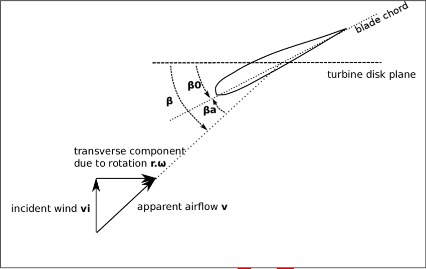

It's two steps: conversion of angular speed to linear speed and addition of vectors.
Imagine you are attached to the blade at a distance r from the axle, facing the wind.
If the blade is rotating at 2π rad/sec, how fast are you moving sideways? That makes it feel as though the wind is blowing at that speed across you.
At the same time, the wind has a velocity 15m/s into your face. Draw a diagram showing these two perpendicular components of the wind's apparent velocity. Completing the rectangle, the diagonal represents the resultant velocity. At what angle is the resultant?

Imagine you are standing still and a wind is blowing. The direction you feel the wind is going is the inflow angle.
Say it's coming from the North at 3m/s. Now you run East at 3m/s. You now feel the wind as though it is coming from the Northeast at 3√2 m/s. As far as you are concerned, this is now the flow angle (i.e. towards the SW).
What about a turbine blade rotating to the East? Near the hub it is only moving slowly, so the flow angle is pretty much from the North. Further out, the wind will seem to be more and more from the East.
Note that this has nothing to do with the shape of the blade.
Back to you, standing still. You now hold out a flat plate, vertically, pointing North. This is parallel to the wind. The angle of attack of the wind on the plate is zero. Turning the plate to the NE, the angle of attack on the plate is 45 degrees. Still holding the plate at that angle, you run E at 3m/s again. The apparent direction of the wind is from the Northeast, as before, so is again parallel to the plate, and the angle of attack is back to zero.
A turbine blade has a twist, so even when it is not rotating the angle of attack of the wind changes along its length. When it is rotating, the angle of attack at a given radius depends partly on this twist and partly on the way the flow angle changes.

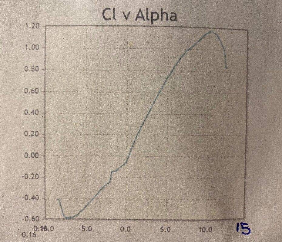

I have to calculate the pitch angle from the angle of attack and lift coefficient but I have no idea what formula to use.
I observe some information is missing:
Cl, Alpha in the attached graph, what they are, which axes they are on and what units they have ?
What is the relation between angle of attack and them?
What is the meaning of pitch angle?
As angle of attack increases, CL increases, up to the point of stall; then most lift effect is lost.
Based on this picture, I understand what the angle of attack is. However, I understand that the pitch angle is formed by the twisted angle and the global pitch angle. I do understand what the twisted angle is but I do not know the definition of global pitch angle or what it does to the wind turbine blade. Could someone help me please?
It looks to me that the global pitch angle is the angle between the plane of blade rotation and the chord line.
But I could interpret the diagram as saying it is the angle between the section twist angle and the chord line. That would be a problem for me because I cannot figure out from it what the section twist angle means.
You say you know what the "twisted angle" means. Is that the same as "section twist angle"? If so, please define it.
Similarly, you mention a "pitch angle", as distinct from "global pitch angle", but that is not mentioned in the diagram.
Please try to use exactly the same terminology as in the diagram, and for any terms not covered by the diagram please provide your definition.

I found your diagram at https://www.sciencedirect.com/science/article/pii/S221509861500155X.
There it explains that
"With respect to plane of rotation, the chord line of the cross section is given a twist called the section twist angle β."
What's confusing is that there should be two diagrams. In the base diagram φ would be zero and the chord line would be at the section twist angle. The local pitch angle would be the same as the section twist angle.
Typically (?), there is a swivel at the base of the blade, where it attaches to the hub. Rotating this swivel adds the same twist all along the blade. The extra twist this provides is the global pitch angle.
So, at any section along the blade, the local pitch angle equals the global pitch angle plus the (local) twist angle. This is the situation in the given
diagram.
