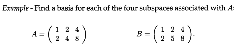

How they found the left nullspace in each of these examples

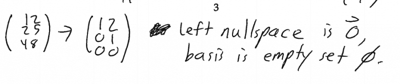

Part b)
http://www.math.utah.edu/~zwick/Classes/Fall2012_2270/Lectures/Lecture19_with_Examples.pdf
For B
Left nullspace is solution to A ^ T times Y =0
So we have a free variable for the third row so don't we have infinitely many solutions as x3 could be anything?
In this problem's part b) I don't think that they took the transpose of the matrix A.

So why isn't the last three rows of 0's in A just the left nullspace?
I am trying to figure out why
B is a 2x3 matrix, so it maps vectors from ##\mathbb{R}^3## to ##\mathbb{R}^2##. In which of these two vector spaces does the left nullspace reside?

You start with the (untransposed) A and form the augmented matrix [A | I] and perform row operations to produce [U | B]. The basis vectors are the last m-r rows of B. So why are you thinking the rows of A have anything to do with the basis of the left nullspace? It should be clear the last three rows of A can't form basis because they're all 0s.

I simply paraphrased the passage you quoted from the PDF, so I'm not sure what you're disagreeing with. As a result of the row operations, matrix A turns into U, and the identity matrix turns into B. The passage says the last rows of B then form a basis for the left nullspace.
