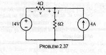

I have to find i and v in the figure.I first tried using Kirchhoff's second law but then I noticed that in the current 4 A I don't have a potential...How can I apply current and potential division here?
Will it look smth like v=[4/(4+6)]*14 V?

You do "have a potential". The voltage across the current source is the same as the voltage across the 6 ohm resistor but does that help.
Have you applied KCL?
