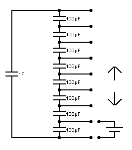

Maybe it is possible to make a charge pump-like voltage multiplier that would extract more power than it consumes, provided that there is already an existing reserve?
I don't need a cold start capability.
Simplified (maybe excessively so, but that works manually) what it would take is this:
The source's connection moves back and forth along the smaller capacitors, and the big capacitor is charged as the result.
Problem is, i can't find any way to make a relay that would take less than 2mA each, and that thing would need 16.
Is there any practical way to do this kind of switching, or practical way of doing some other kind of charge pump within an order of 10μA power budget?

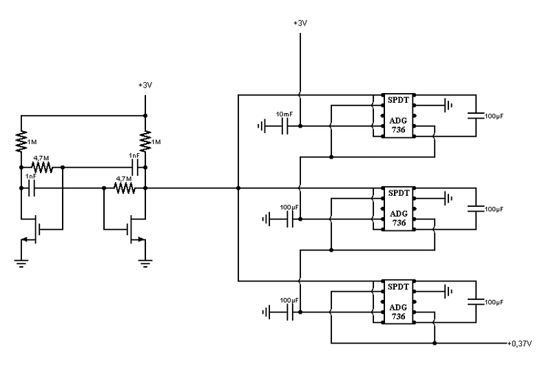

Ok, some simplifications later i got a proof of concept on the charge pump idea:
The flip-flop consumes about 6μA, the switch side consumes less than i can measure.
From 1.5mA at 0.45V this gets about 250μA at 1V of raw output, and is quite capable of maintaining itself once the big capacitor is charged over 2.4V.
The voltage gain is close to clear 8x.
I haven't tried to optimize the design yet - frequency (~70Hz) or capacitor sizes might be way off optimal.
Also, the power leaks out if the source voltage drops - might need a schottky diode between the last stage and the big capacitor.
So, how can this be improved?
Anyone knows how to make a sub-μA square wave oscillator for ~100Hz?

A series regulator would only add unnecessary complexity to the circuit. The output voltage (=> switching frequency) can be adjusted, quite accurately to constant load, from the base resistor of the switching transistor. The 5V zener would only be there to make sure maximum voltage is never exceeded.
People who construct "joule thiefs" are dealing with this issue by taking advantage of a clever trick associated with synchronouse boost converters -
Since a synchronous boost uses MOSFETs, they don't have a junction drop to creat a lower limit.
Also, synchronous boos converters typically use the output voltage to supply drive to the MOSFET gates. So, after the device is started at a sufficeintly high voltage, it will continue to operate at much lower voltages.
Of course, the issue then is getting enough voltage to start...
