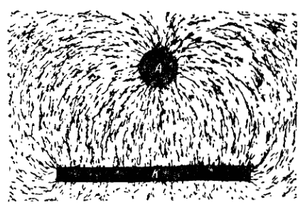

Hello! I think this illustration will help you figure out your questions. The figure shows the electric field lines between the plate and the wire. The wire in this case can be considered a "smaller plate". As you can see, the field lines are evenly distributed between the larger and smaller plates. If the smaller plate is moved (dragged) relative to the larger plate without changing the distance between them, the system parameters will not change.
@Ivan Nikiforov I believe this is only the case if the "conductor" or second plate is a considerable distance away from the first plate.
If the separation distance is small (much less than a milimeter) and the plate surface area is also small compared to the larger plate, then I believe this image doesn't hold , because the E field is largely contained between the overlapping surfaces.
Maybe other can comment too.

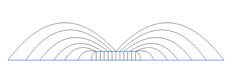

It seems to me that the pattern of electric field lines would look something like this, right? It is fundamentally important that the large plate, being the lining of the capacitor, has a charge over the entire surface.
I haven't been following this thread, but that diagram does not look correct to me. The charge and field lines will be concentrated on the large plate in the vicinity of the small plate, I believe. The charge distribution on the large plate would not be uniform. Think of an infinitely large plate -- there is no way the charge could be uniform.
You're right. The second figure #9 shows that the density of the lines of force between the plates is higher than outside them. The main idea that I wanted to outline is that a large plate has a charge over its entire surface. If you move the smaller plate in Figure #9 to the left, the lines of force will enter the space between the plates on the left and will exit this space on the right. At the same time, the system parameters won't change, right?

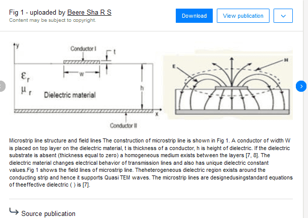

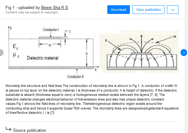

Yes. It's probably easiest to think in terms of equipotential lines. Those equipotential lines are at the surfaces of the two conducting plates, and encircle the smaller plate. The E-field lines must cross the equipotential lines at right angles, and those E-field lines must start and end on charges.
https://www.researchgate.net/figure...of-microstrip-line-is-shown-in_fig6_291339518
As an argument that a large plate has a charge over its entire surface, I'll give you an example. There are thousands of miles of direct current transmission lines. If such a wire is connected to the "+" terminal of the generator, then it is obvious that the wire has a charge along its entire length. This charge can be measured at any point on the wire. Let's say at some point we bring a smaller plate closer to this wire and connect it to the "-" generator. Will this cause the "+" to disappear along the entire length of the wire?
@Ivan Nikiforov I think the example of the HVDC wire is not the best one because there as you already said , the + is the long wire and the - is the small plate - in this situation ofcourse all the charge will reside between the two bodies with the small plate having an enormous charge density and the long + wire having charges across its length , although even here the charge density would be higher directly next to the small plate and decrease further away from it.
Rather why won't you look at the example I gave, two very long rectangular plates with a small rectangular plate between them, the width is the same for all 3 plates for simplicity but the length is not. Would you say that there is almost equal charge density across the two long plates (both long plates assume +, small plate -)?
It makes no sense because the E field is strongest in the area of overlap, so the further you go from the small plate the E field should get weaker and charge density decrease , is this not true?
@berkeman yes I agree the picture you provided with just 2 plates where the bigger one is not that much bigger than the smaller one seems true, but consider the scenario I provided with a short plate between two very long ones, I believe the situation would be much different.
My argument is this - with two long plates and one small, being very close together with a very thin dielectric the E field would naturally want to exist in the overlap region, for there to be charges further along the long plates it would mean the E field would need to extend from the small plate side through a very long layer of dielectric (the direction being parallel to the plate surface) in order to reach further down the long plates, from my understanding the E field would drop in value rather quickly therefore I can't see how there would be any considerable charge density further away from the small plate.
It certainly falls off quickly, but is not zero. :smile:
The key thing about a conductive capacitor plate, is that it is an equipotential, but the charge density distribution at the surface, will depend on the presence of other potentials nearby, that will repel or attract electrons, in or out between the more positive nuclei of the capacitor plate.
A small positive patch, close to a large negative plate, will draw electrons out of the large plate surface. Since C = Q / V, the charge drawn out will be Q = C⋅V ; That is, for a fixed voltage, charge is proportional to the capacitance.
If the positive patch is then moved around on the plate, the mound of electrons on the plate surface will be dragged about, following the moving patch. A momentary surface current of electrons will flow, where the edge of the small moving patch, covers or uncovers the larger plate.
When the large plate is infinite and earthed we can apply mirror image method to get electric field E, i.e. that of a small plates pair with double distance. The infinite plate holds same amount of negative charge with the small plate.
( OP question in another thread may be staed in this infinite ideal condition that when the infinite Earthed plate moves horizontally with close to light speed does E change or not ? )

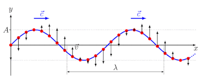

Perhaps this animation demonstrates the process you're talking about? If this is the case, then as the smaller plate moves, the electrons simply oscillate up and down. Obviously, there is no surface current in this case, since the electrons do not move in the direction of the plate movement.
View attachment 356545 Perhaps this animation demonstrates the process you're talking about? If this is the case, then as the smaller plate moves, the electrons simply oscillate up and down. Obviously, there is no surface current in this case, since the electrons do not move in the direction of the plate movement.
I am not confident that this simulation shows the full picture. I believe there is a perpendicular to surface current present just like in your animation, but I believe there also has to be a parallel to surface current present.
I think of a positive test charge being placed above the long plate and then moved around, the E field is moving so it interacts with multiple electrons at any given time, so as the field moves it must be that the electrons can't just move up and down , because the field interacting with those electrons has a parallel to plate direction therefore the electrons must also be deflected and move in the direction of the field by their mean free path just like they do in a current carrying wire.
Sure there is not a net current because both positive and negative charges are equal and move at the same speed but if we ignore the upper plate or charge, then there I think is a real net movement of electrons on the lower larger plate.

... because the field interacting with those electrons has a parallel to plate direction therefore the electrons must also be deflected and move in the direction of the field by their mean free path just like they do in a current carrying wire.
"The electric field lines always end at the bodies forming the capacitor and approach the surface of these bodies perpendicular to it"
I believe this is true only in the static case. If there is a moving E field (whether because of physical motion of charged object or electronic switching) then there should be two components, one perpendicular and one parallel to surface or at an angle, because it takes time for the charge to redistribute to the new position and as it is redistributing/aligning the field is not perpendicular which I believe is what drives that redistribution, otherwise there would be no need for charge to redistribute.
FusionJim said:
Please correct me if I am wrong.
You are wrong.
The mound of electrons under the patch is moved, very slowly, by electrostatic attraction from above. The entire capacitor plate is an equipotential, so there is no differential voltage across the plate. C = Q / V, has fixed voltage, so Q is decided by the changing distribution of C.
