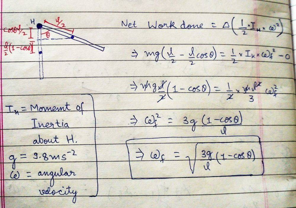

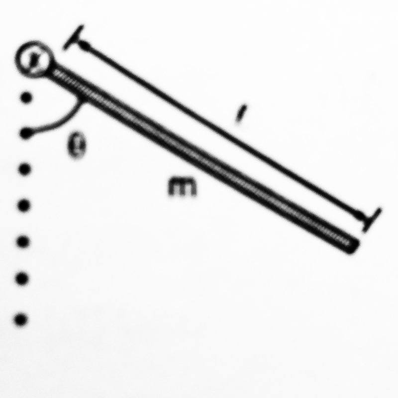

In the figure shown a uniform rod of mass m and length l is hinged. The rod is released when the rod makes angle θ with the vertical.
Find
A) The angular velocity of the rod at the lowest position.
B) Normal Reaction due to the hinge just after the rod is released
I have solved problem (A).
But I couldn't solve problem (B).

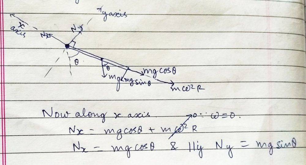

Here is my attempt:

The equations you have written in part B seem to be statics equations, but the rod will be accelerating.

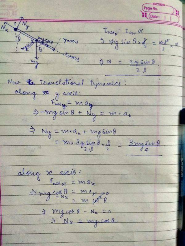

You are absolutely right. Here is my attempt. Please verify the solution.
You have a few sign errors.
Which ways are you taking as positive for at?
And which way does centripetal acceleration act? (But that error didn’t matter because it is zero.)
You also seem to have dropped the mg sin theta term in Ny.

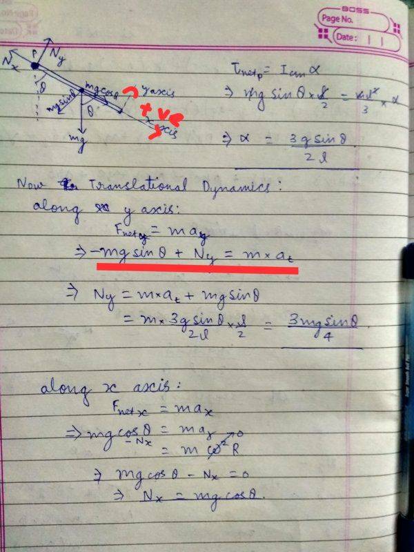

The signs are denoted in this image. And I haven't dropped the mgsin theta term. Also the at is taken in the +ve y-axis side (i.e. along Ny).
mmaismma said:
The signs are denoted in this image. And I haven't dropped the mgsin theta term. Also the at is taken in the +ve y-axis side (i.e. along Ny).View attachment 255076
Ok, so at is positive up, but then which way are you taking α as positive, and what then is the correct relationship between them?
Wrt the mg sin(theta) term you have not underscored the line I had in mind. (This is an example of why the guidelines say not to post working as images. If you take the trouble to type it in it is much easier to refer to. Or you could number your equations.)
Look at the next two lines. Nothing missing?

Sorry. My bad. Here is my revised attempt. Please check.
\begin{align}
\Rightarrow F_{net}{}_{x} &=ma_x\nonumber\\
\Rightarrow mg\sin \theta - N_y &= ma_t \nonumber\\
\Rightarrow N_y &= mg\sin \theta - ma_t \nonumber\\
&= mg\sin\theta -m \times \frac {3g\sin\theta} {2l} \times \frac {l} {2} \nonumber\\
\Rightarrow \mathbf {N_y = \frac {mg\sin \theta}{4}}\end{align}
