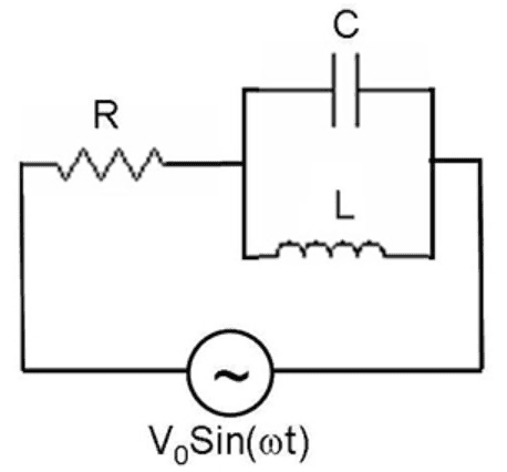

I am stuck on the following problem.
Determine an expression for ##V_C##, the voltage across the capacitor.
Actually, I would like to solve the problem for every variable.
Here is the circuit as it appears in MIT OCW Vibrations and Waves Problem Solving course
Circuit schematic: a sinusoidal voltage source V0 Sin(ωt) in series with resistor R, feeding a parallel branch containing capacitor C on top and inductor L below.

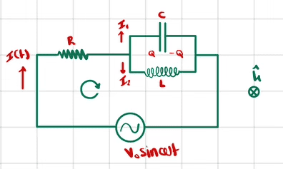

Here is my own picture
Hand-drawn circuit schematic: a series resistor R with current I(t) feeds a parallel LC tank of capacitor C (charge Q, -Q) and inductor L, driven by a sinusoidal source V0 sin ωt; loop currents I1 and I2 marked.
I wrote equations for the three loops.
Outer Loop Through ##C##
$$-V_0\sin{\omega t}+IR+\frac{Q}{C}=0\tag{1}$$
Outer Look Through ##L##
$$-V_0\sin{\omega t}+IR=-L\dot{I}_2\tag{2}$$
Small Inner Loop
$$\frac{Q}{C}=L\dot{I}_2\tag{3}$$
Only two of these equations are independent. We can obtain the third equation given any two of the equations.
We also have
$$I=I_1+I_2\tag{4}$$
$$I_1=\dot{Q}\tag{5}$$
I am really not sure what to do at this point. I've tried to manipulate the equations above to get a differential equation just in one of the variables but I cannot. For example
$$-V_0\sin{\omega t}+(\dot{Q}+I_2)R+L(\dot{I}-\ddot{Q})=0\tag{6}$$
$$\ddot{Q}-\frac{R}{L}\dot{Q}-\frac{R}{L}I_2=-\frac{V_0}{L}\sin{\omega t}+\dot{I}\tag{7}$$
I would very much appreciate some help here.

Sorry, I haven't really reviewed your DEs. But here's another approach.
Since the driving function is a sine wave, and this is a linear network, you know the answer will be a sinusoid at the same frequency with some different magnitude and phase. So you could just use the idea of complex valued impedances (phasors) and solve for just the magnitude and phase. Then this problem is a fairly simple voltage divider.
This is similar to the Laplace transform approach, where you set s=jω for the steady state solutions. You really don't have to (or want to) do the inverse transform.

I prefer KCL node equations over KVL loop equations.
I would ground the lower left node between the AC signal generator and the resistor to provide a reference node, and then I would number the node between the R and the LC as "1" and the right node as "2".
Sum currents leaving Node 1:
$$ \frac{V_1(wt)}{R} = C \frac{d(V_1(wt)-V_2(wt))}{dt} + \frac{1}{L} \int(V_1(wt)-V_2(wt))dt $$
Where ##V_2(wt) = V_0 sin(wt)##
So you need to solve for ##V_1(wt)##
Does that help at all?

Your DEs are correct, so one take on this is just a Math problem. You have a bunch of choices for the variables to solve for (charge, currents, voltages, etc.) but you do need a complete independent set. There's no point choosing capacitor voltage and capacitor charge for example, they are trivially related and don't span the solution space. Normally, a simple rule to create a complete description of the state space is to choose each capacitor voltage and each inductor current. These are the quantities that "remember" the history of the system (state) and all other quantities can be calculated from them. But, you could choose others, like capacitor current in place of voltage, or even more complex combinations.
So here is the work you've already done reformatted in a canonical state space formulation:
Note first that I'll use ##v_c(t)## and ## i_l(t)##, the cap voltage and inductor current as my state variables. I'll also name the driving voltage ##v_s##, just to save extra typing.
Then some equivalence relations to map to your equations: ## I_1 = C \dot{v_c} ## and ## I = i_l + C \dot{v_c} ##
Then the outer KVL loop equation is ##R(C \dot{v_c} + i_l) + v_c - v_s =0 ~~ \Rightarrow ~~
\dot {v_c} = \frac{-1}{RC} v_c - \frac{1}{C} i_l + v_s##
The small loop is simply ##\dot {i_l} = \frac{1}{L} v_c##

In terms of##I_1## and ##I_2##, you write (2) as
$$(I_1+I_2)R + L\dot{I}_2 = V_0 \sin\omega t.$$ Differentiating (3) with respect to time gives you
$$\frac{I_1}{C} = L\ddot{I}_2.$$ Combining those two equations, you get
$$(LC \ddot{I}_2+I_2)R + L\dot{I}_2 = V_0 \sin\omega t,$$ which is a second-order differential equation in just ##I_2##.
